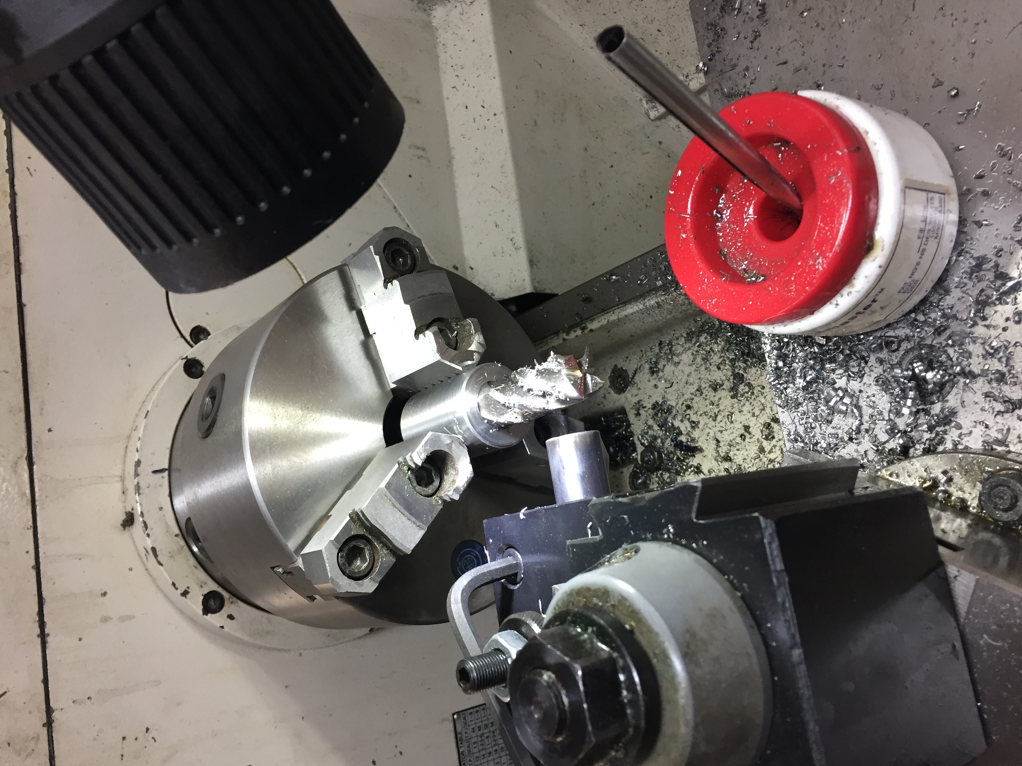

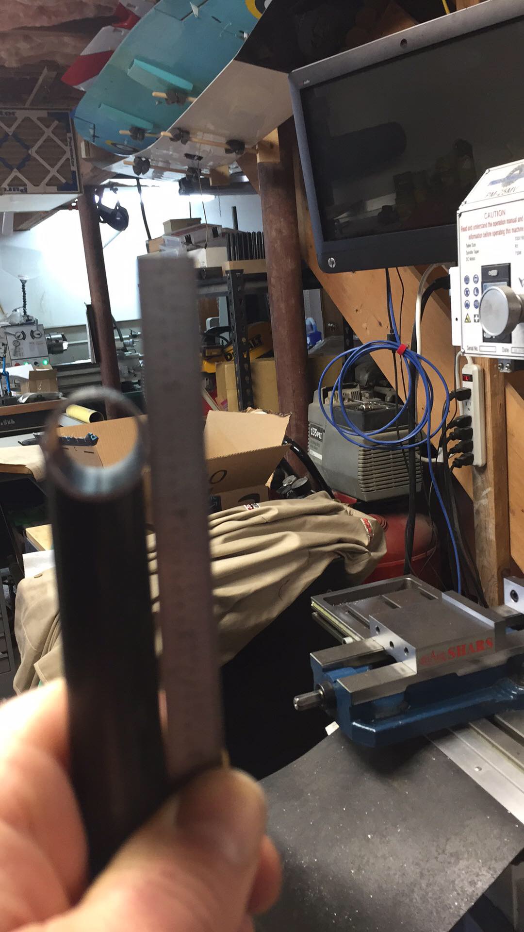

I’m getting tuned up to start welding my fuselage and have some questions on how the notching was done.
I’ve tried to get results from using a tubing notcher, a mill, and a lathe.
So far the mill gives the best results but anything except perpendicular is difficult.
The lathe seems to be the best. The notcher gave the worst as the center of the cutter was not inline with the tube giving the results shown. What seems the most popular way of notching out there?

Thanks for the input guys.
I’ll be TIG welding and the lathe is now producing some outstanding fit ups. I will play some more with the notcher but in the end I think the lathe will do.
On a side note on notching, did you guys cut a full radius into the tube or just notch till you came in tangent to the ID of the tube? I’m thinking not that deep, just to the ID of the tube so you don’t weld over a paper thin section of ear on the tube. Thoughts?

I also found that my tube notcher was off-center. I fixed it with a shim made out of aluminum sheet. It has served me well since. The question about the thickness (or thin-ness) of the "ears" of the notched tube is valid, but you will soon find that it is easy to compensate for it with good welding technique.
The important lesson here (in my mind) is that it is perfectly fine to modify your tools to make them better for you, as well as to find the best tools and technique that works for you.
