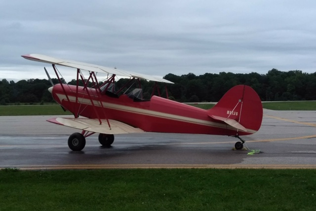

Scott,
We'd love to see some pics.

Re: Wood spar inspection
Nice looking ship!
