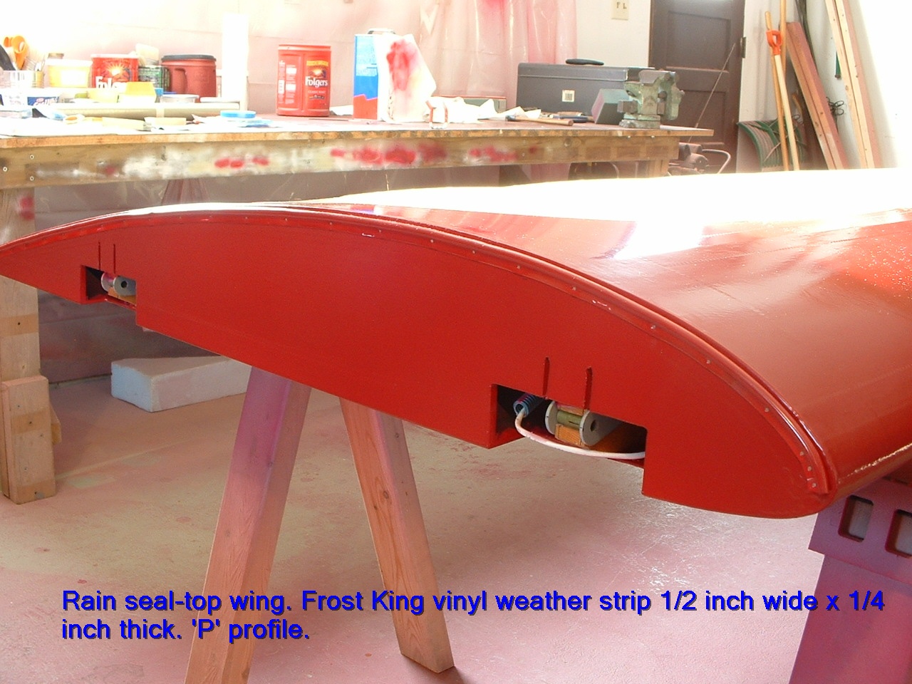

This seal should be available at your local hardware store. It's vinyl with a 'P' shaped profile and seals very well. Also may be painted to match your wing and ours has held paint nicely for 11 years.
Top Wings44 12-19-08.jpg.JPG (402.47 KiB) Viewed 4561 times

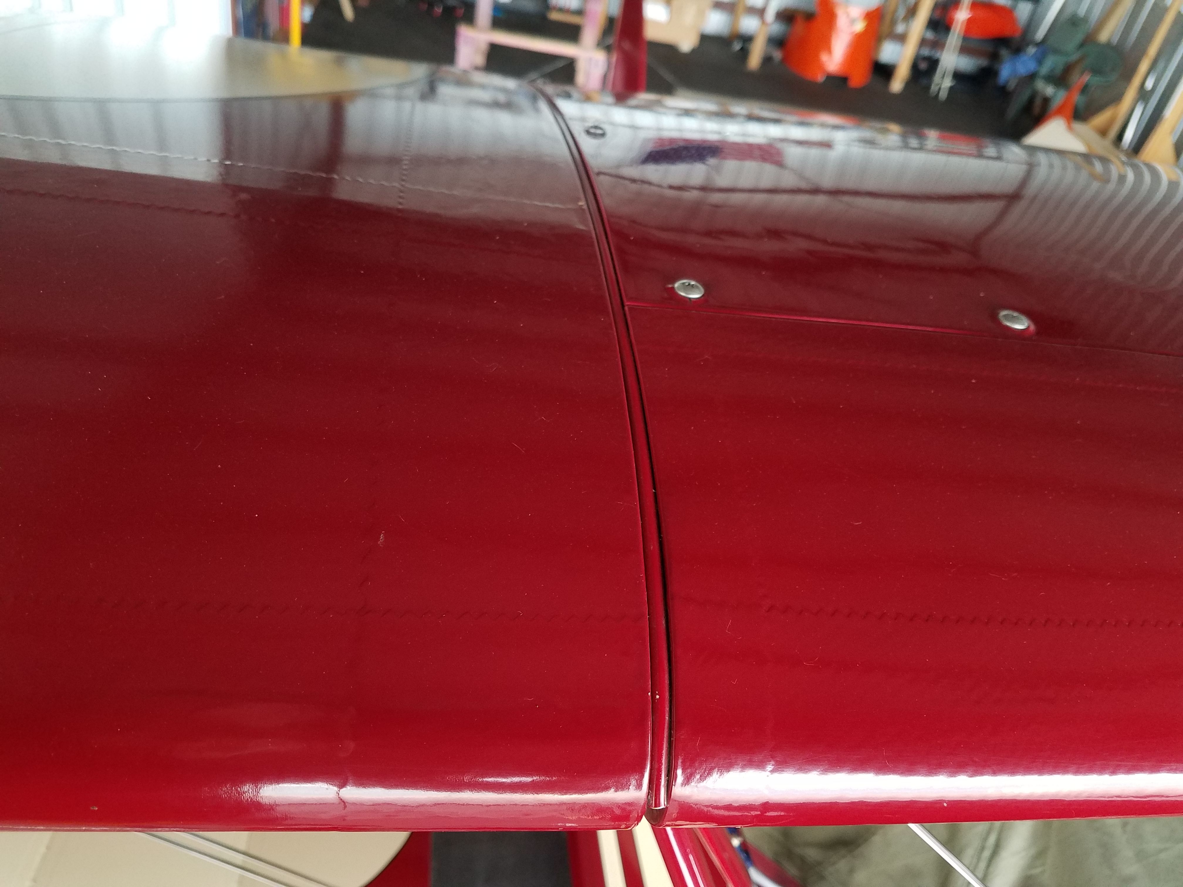

Here is a photo with the wing panels together. Sorry, I don't know how to reduce the file size.
Top Wings45a 06-19-19.jpg (2.95 MiB) Viewed 4549 times

Thanks for the suggestions. As the wings are on I’m looking at the metal strip method or other. I like your method Jon but the gap on my wings is more than 1/2”.
