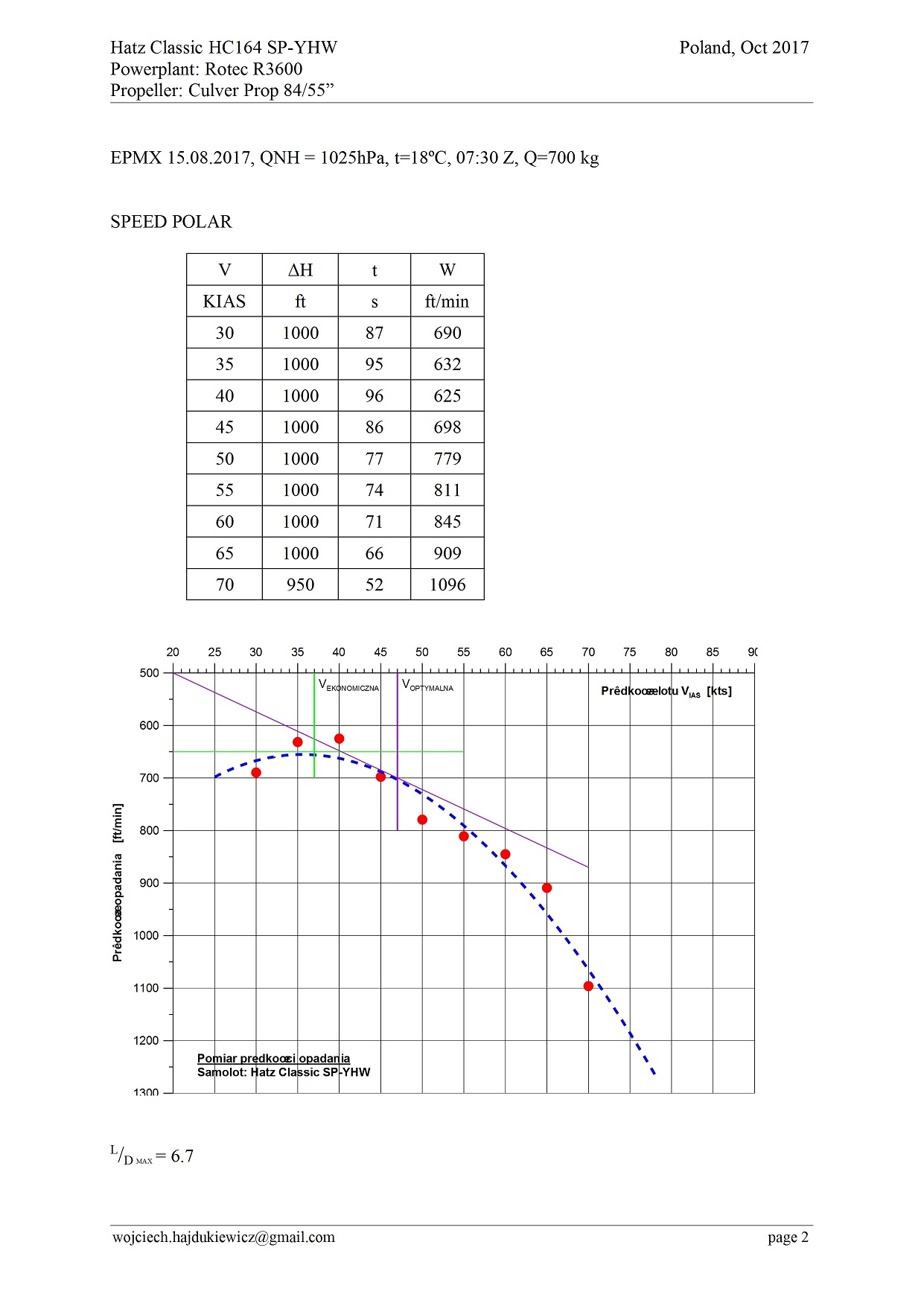

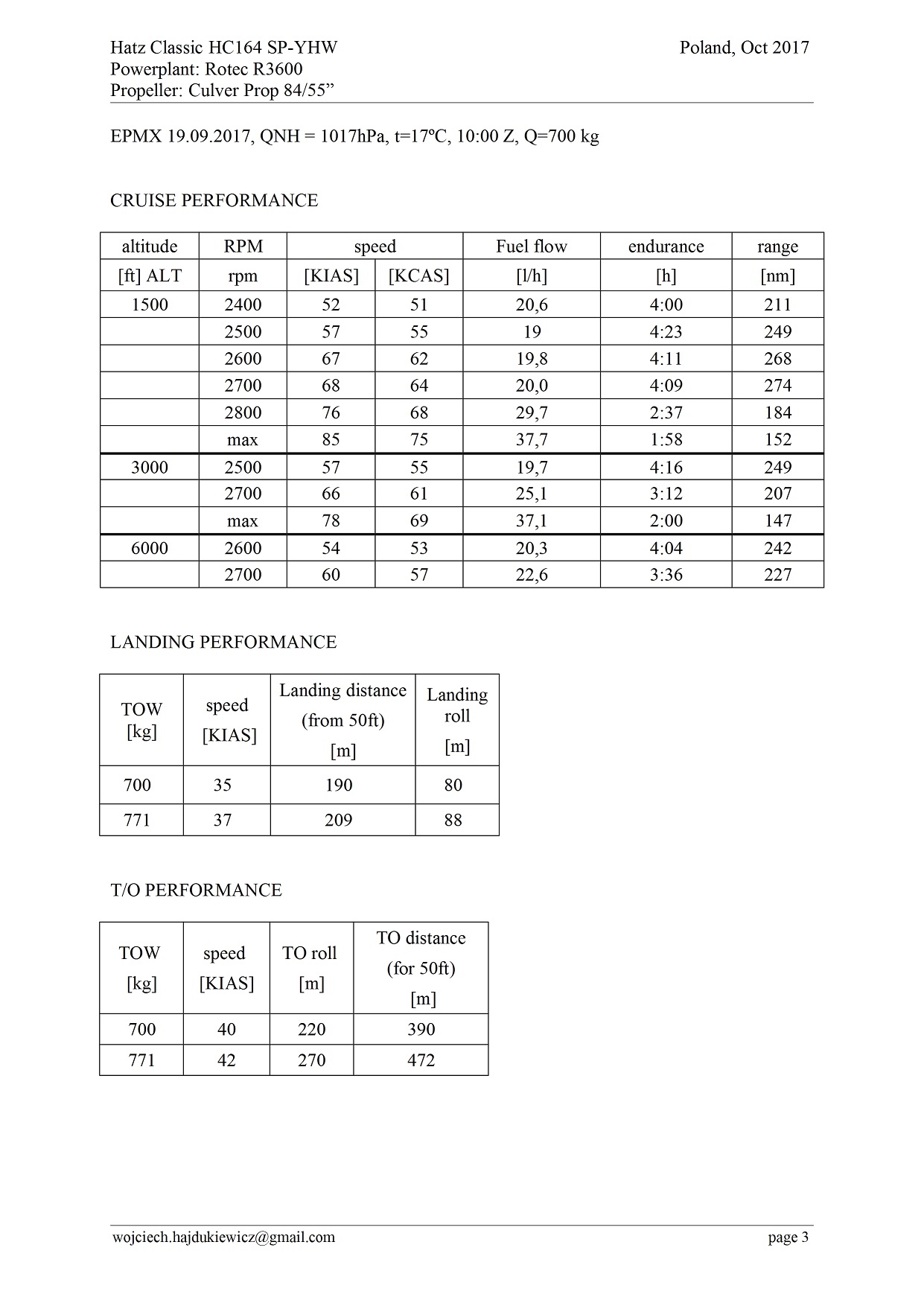

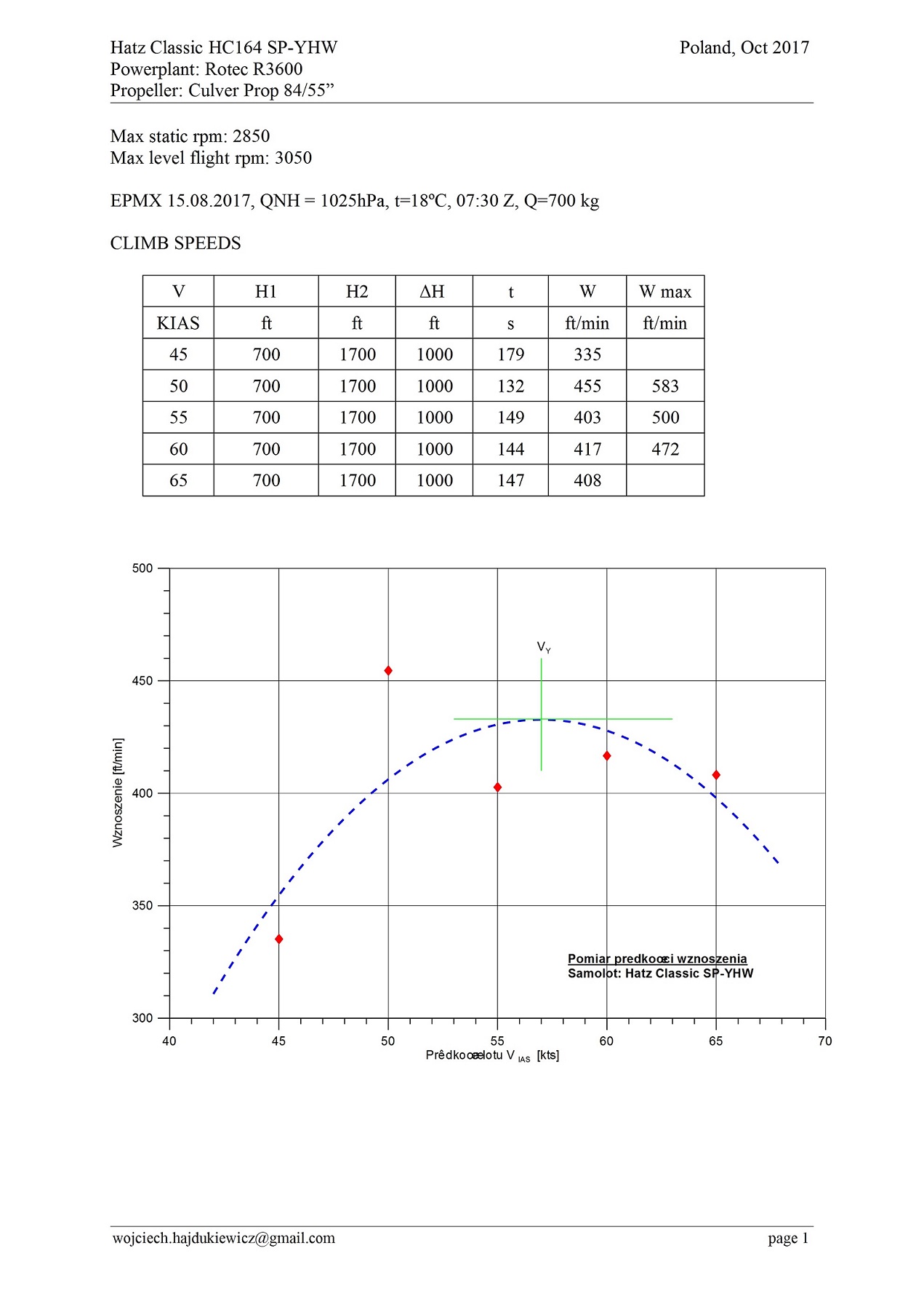

Hello all!
Here you can find few performance sheets of my white-red Hatz Classic I have just prepared for all hatzers from this forum. All sheets in jpg format.
As you can see Culver Prop 84/55" is rather "cruise" prop...
Hatz Classic perf p1.jpg (215.14 KiB) Viewed 2625 times
Hatz Classic perf p2.jpg (232.82 KiB) Viewed 2625 times
Hatz Classic perf p3.jpg (280.66 KiB) Viewed 2625 times
