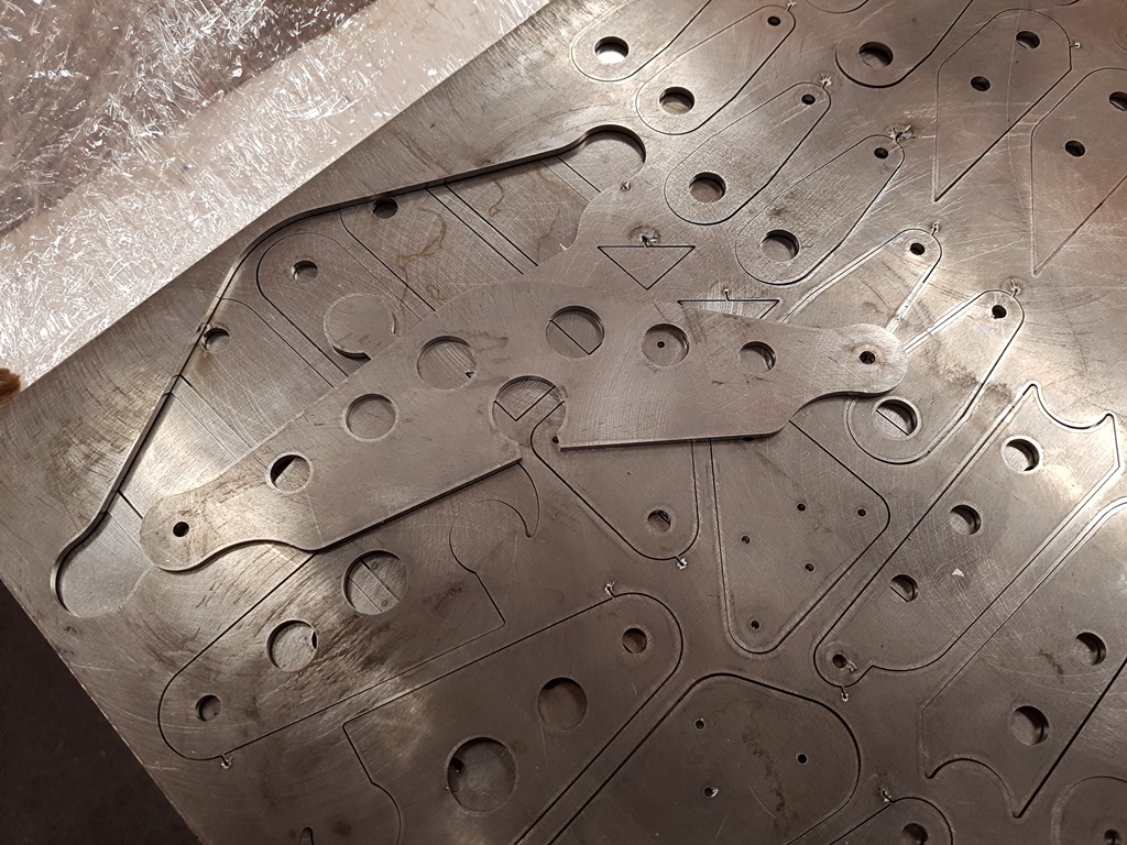

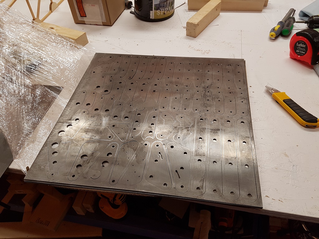

I originally was going to have them water jet cut but they talked me into laser cutting them for about half the cost. I had the DXF drawings from this forum but reorganized them. I went through all the drawings and sorted the metal parts by drawing number/part number/thickness and number required. I checked the dimensions of the parts already drafted and drafted a few that weren't already done. One drawing per part. I use AutoCAD for work so the drafting was the easy part for me. I gave these drawings to the shop and they organized them on the metal sheets I supplied. They came out fairly nice. The holes are all undersized. I drilled and reamed them to the correct size.
I only did the 090 4130 stuff for now - 97 parts. It all fit on three 18x18 sheets. Except for the spar fitting lugs I think all the wing hardware is 090 4130.

I started epoxy painting them. No comments on that process yet.

I not sure that laser cutting detrimentally affects the metal. I did wear out a few 3/16" drills resizing the holes as the metal seems to be hardened along the edge of the laser cut. But probably no different than the edge of a TIG weld.
