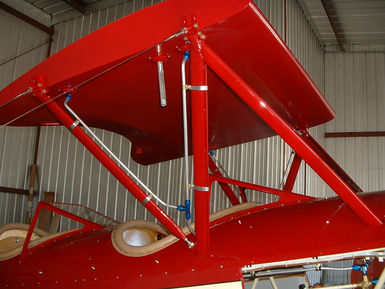

I think the plans call for a Stearman fuel gauge. We used a PA-12 fuel gauge (Wag-Aero) which uses the same flanges as the outlets.
- Fuel Lines04 09-24-08.jpg.JPG (325.36 KiB) Viewed 3873 times
