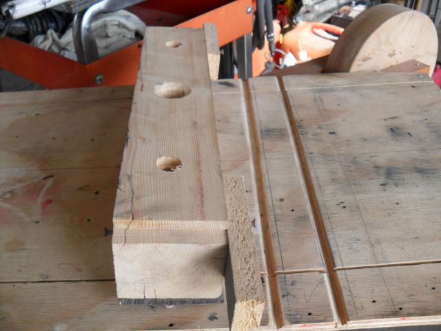

Upper view of die to fit press.
Aileron skin dies top view.jpg (73.46 KiB) Viewed 3303 times

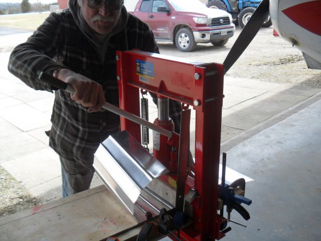

As you can you can see by the curl of the skin due to spring back it requires tweaking afterwards in the brake to finish. It is a lot of work but I have more time than money.
Aileron skin press.jpg (74.22 KiB) Viewed 3303 times

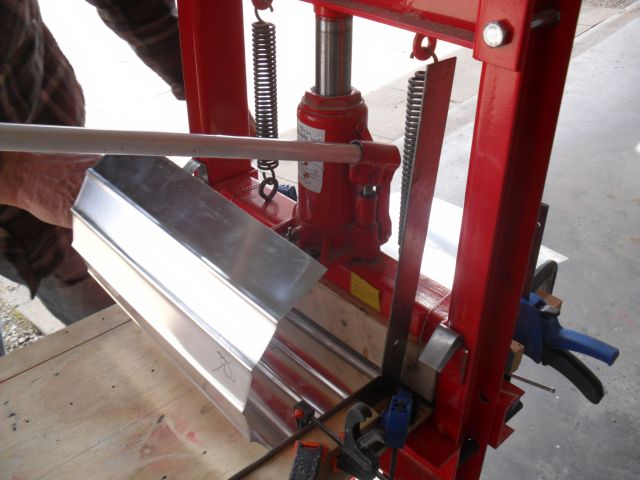

Aileron skin press detail.jpg (81.87 KiB) Viewed 3303 times

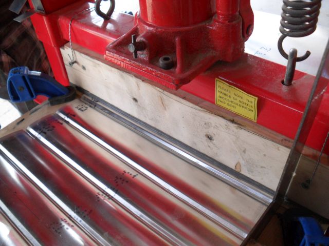

I am feeding from my left and indexing the previous corrugation in 2nd groove. I found that when I held the sheet in the 2nd groove that the spacing widened. I then tried using my left  hand on the feed side sheet when starting the press it worked perfectly. Creates scrap until you get it right.
Aileron skin pressing.jpg (77.49 KiB) Viewed 3303 times

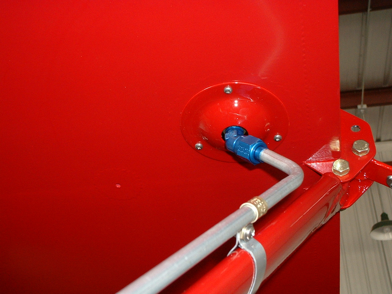

Another use for a press like this would be making the round fairings for the fuel tank outlets. I made mine with fiber glass but it would be easy to punch them out from soft aluminum. The press is available from Harbor Freight for a pretty reasonable price. The forms could be turned out on a lathe using cherry or maple wood.
Fuel Lines07 09-24-08.jpg.JPG (310.65 KiB) Viewed 3265 times
