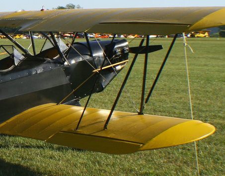

Re: CB-1 aileron
I did that also.
Attached is a picture of my wings. I just made the aileron/wing tip the same shape as original.

Re: CB-1 aileron
Thanks Jeff for the pics and the input. I sure think I feel better about it even though technically there absolutely nothing wrong with the plans airplane! I've already got another full sized rib in the jig to replace #10. I'll use the original on another wing ahead of the aileron there.
