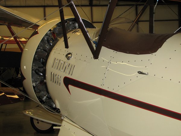

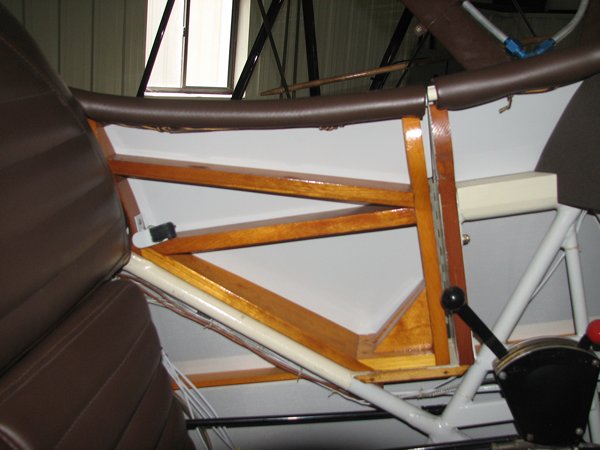

Ed, cutting the longeron and reinforcing the area to accommodate a door has been done on numerous aircraft over the years. Waco did it on all their open cockpit biplanes and the Bakeng Deuce is at least one experimental I can think of that's done it as well. I have a set of QCF drawings that I'm using as reference to do the same thing on my Hatz. Properly done it is definitely achievable.
Here's a couple QCF pics...

Altering longerons to install a door is a very significant alteration that needs to be carefully considered. There are a lot of forces at work in that area of the fuselage and I wouldn't be comfortable that a design that works for a parasol like the Deuce would be adequate for a biplane like the Hatz. Even if copying a design like the Waco, you'd still need to consider the tubing sizes and thicknesses to ensure adequate strength.

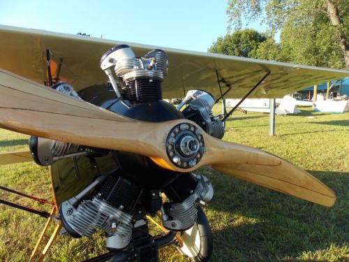

By the way, where are the photos of the Brodhead Hatz gathering and does anyone knows the brand of the radial on this Pietenpol (see photo)?

That would be Frank Pavliga's Piet and I believe it is a Leblonde radial. I was fueling up Sunday morning at Brodhead to head home and Frank was at the pumps with his Piet. It's a beauty!
Re: Fuselage door
Frank's Piet has a 90 horse Lambert on it.
