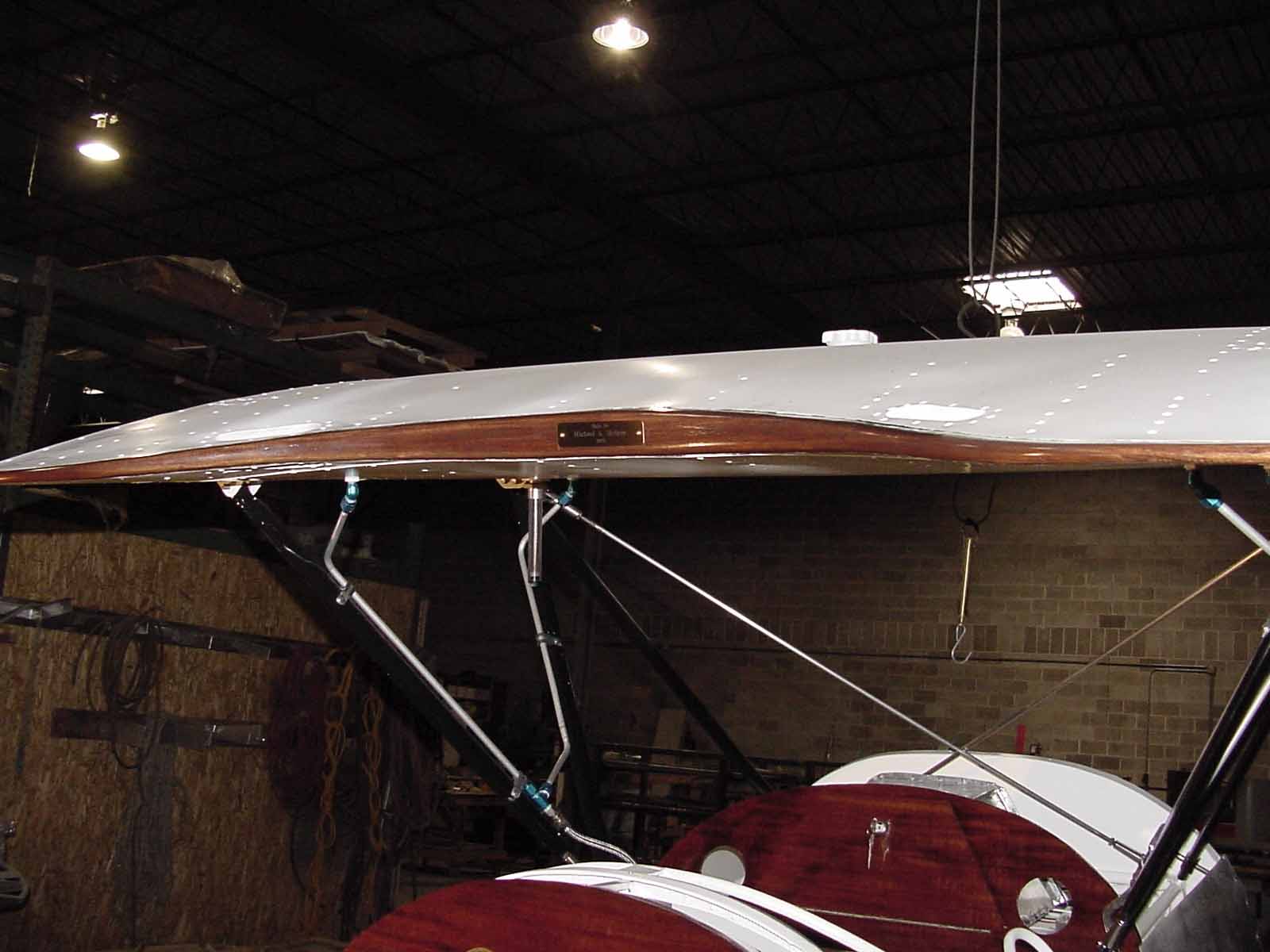

I used Mahagony and covered the center section with aluminum.
N838MM
Center Section.jpg (81.91 KiB) Viewed 3698 times
Re: Center Section Trailing Edge Material
That mahogany sure is pretty wood!
