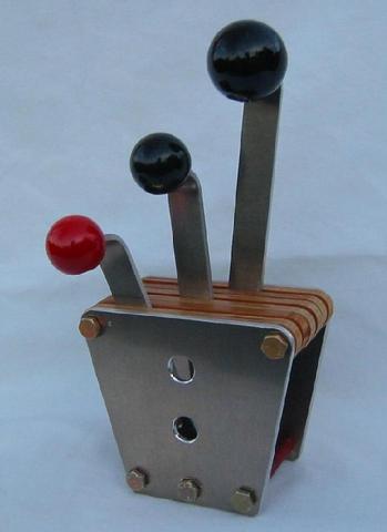

I like the throttle quadrant design (sheet #27), but the more I think about it, the less sense it makes to me:
In my current airplane, and in most planes I have seen, there is no reversal of the throttle and mixture controls - push forward means full throttle / rich mixture.
The throttle quadrant design on page 27 shows that when you push the throttle level all the way forward, the control will reverse and pull the cable all the way back.
seems like this is what we need:
http://baxterquadrants.com/
no reversal.JPG (14.27 KiB) Viewed 3854 times
What have others done?

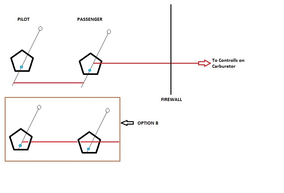

This reinforces my thought that the throttle quadrant which is included in the drawings of the Classic will require a reversal. Seems like it would be better to design the reversal into the throttle (like the one in the picture I attached in my original post) to begin with. The way I see it there are two options that will work:
non-reversing controls
Forgive the crude drawing, it is for conveying the idea only. Option B would save some weight.

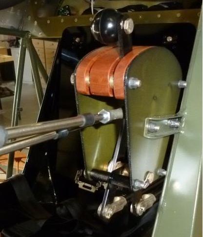

I knew the internet would help. Here's Rick Hansen's solution:
Rick Hansen
Rick Hansen
interconnect the two cockpits below, and connect to carburetor above the pivot point.

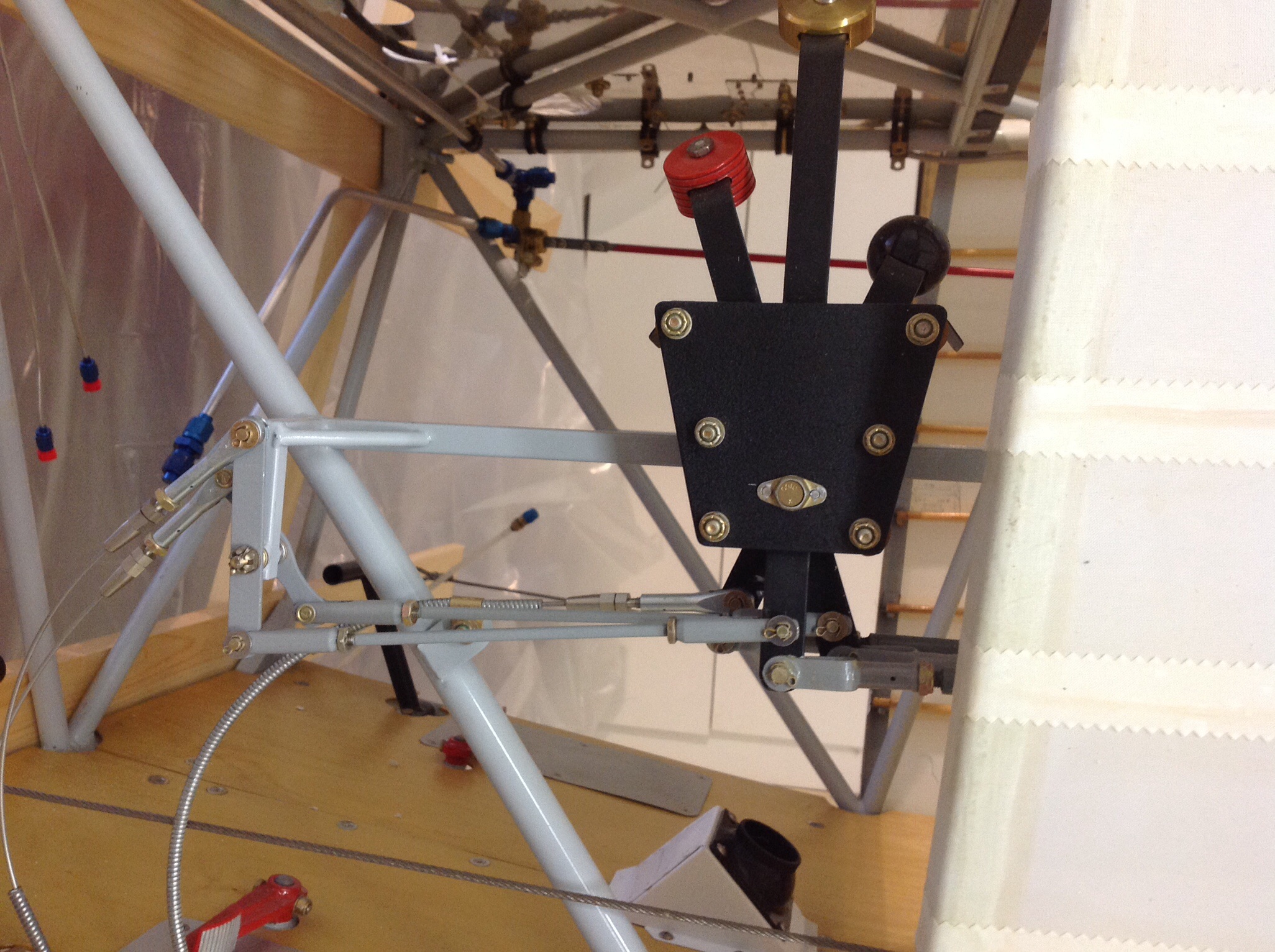

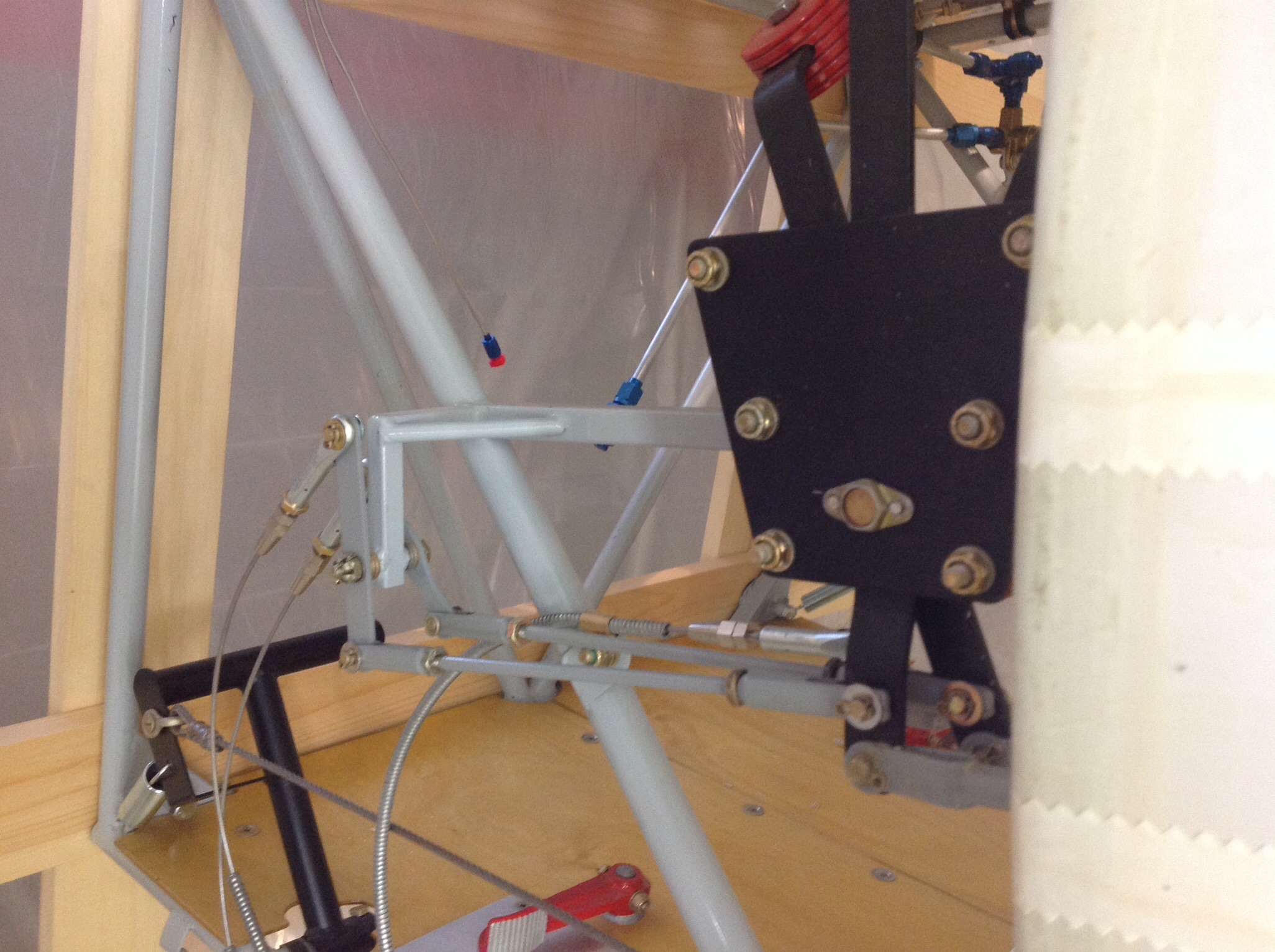

Re: Throttle quadrant - reverse?
Angle View
Angle View
Plain view
Plain view
Here is what I did. Pictures worth a thousand words.
