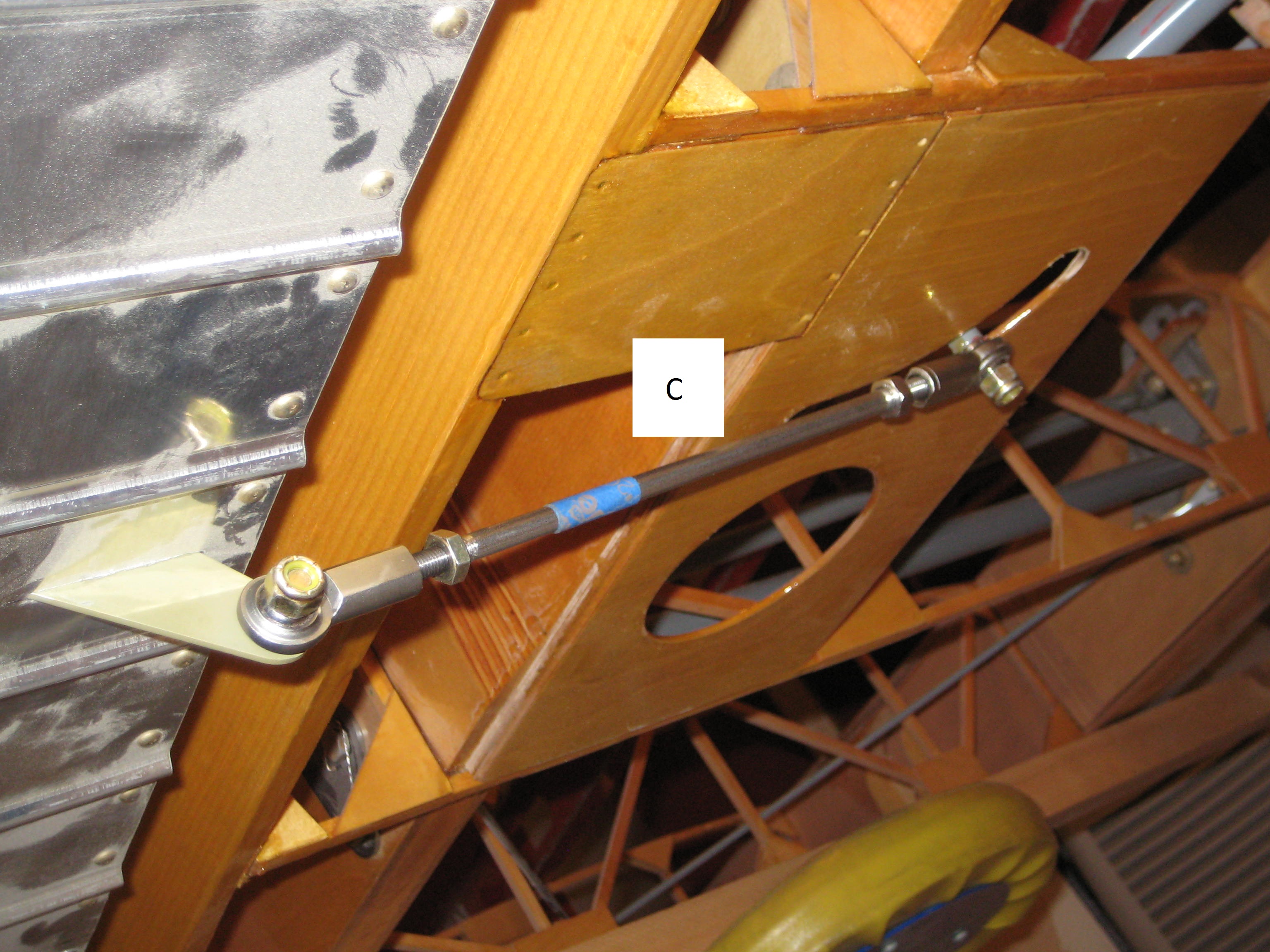

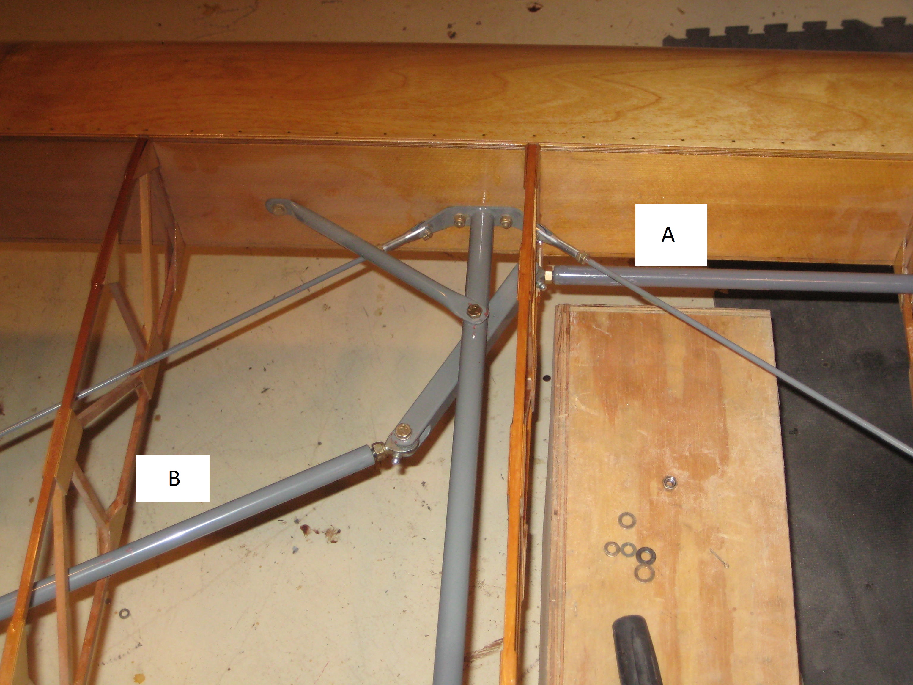

My goal is to have all wings covered before the spring equinox. That written, I am in the process of rigging the aileron throws of 25 degrees up and 20 degrees down as shown in the plans. I am using an electronic level on the upper surface of the aileron just as I do at work checking proper rigging. I place the level mid chord on the Hatz aileron with the trailing edge even with the wings trailing edge. I calibrate the level to 0 degrees and begin to move the centered (plumb) control stick watching the degrees count up to 25 degrees and set the appropriate aileron stop near the torque tube. Then I reverse the movement of the control stick watching the digital readout pass through zero and glad to see the control stick is plumb. Unfortunately with full opposite movement of the control stick I cannot achieve 20 degrees downward deflection.
From what I gather, there are three adjustments I can work with to find the proper combination which will yield 25 up and 20 down. It's getting a little frustrating as making one adjustment affects the other two. So I am asking for advice on a systematic method for setting the aileron throws.
The three adjustments I have to work with are (SEE ATTACHMENTS):
A - The control tube from the torque tube to the idler.
B - The control tube from the idler to the bellcrank.
C - The control rod from the bellcrank to the aileron.
All tubes measure out correctly according to plans. Each adjustable control has a left hand and right hand rod end so I can adjust the length by rotating the tube or rod.

For what it is worth
I secured the stick at dead center
I secured the ailerons at neutral
I set the aileron bell crank at the middle of its travel
I connected the push pull tubes to the stick
I then connected the aileron control rods
My deflections came out to 2 1/2" up and 2" down
Works great
Note: if you go full aileron deflection in a Hatz - you will be upside down pretty quick. My plane requires very little movement for standard rate turns.
N9648B
Works great
N9648B

I'll give your method a try and see how the deflection angles match the plans. To me 25 up and 20 down seems high. As far as the aluminum ailerons go I've got too much time invested in pressing my own skins and fabricating to change horses in mid stream and build wood and fabric replacements.
Thanks much for your rigging recommendation.

Some where in the plans the 25 - 20 degrees is stated at 2" and 2 1/2". I do not know if this (2 - 2 1/2" converts to 20 - 25 degrees)? But these numbers worked well for me. I know on the ailerons, I also pressed my own skin and it was a hard choice to trash them. But some one just starting might investigate this. I made the switch after seeing John Hanson's plane at OSH (he has fabric ailerons)

I'll be rigging this weekend and will do a comparison of angular and linear measures for the throws. One of my first attempts was fixing a vertical stick just aft of the aileron trailing edge with the aileron at neutral (0 degrees). Then I placed a mark 2.5" above neutral and 2.0" below neutral and moved the stick to see what that looked like. It didn't look like much of a deflection in either direction. I certainly am not saying that its wrong because the plans do reference those measurements and I haven't seen any Classic owners show me first person how much their ailerons deflect. To me it just didn't look like enough. I didn't have my electronic protractor at the time so I couldn't get an angular measurement. I will have a better fix on the comparison this Saturday.

As far as aileron deflections. As said before, I have 2" and 2 1/2". While flying and observing the aileron movement in very steep turns, little aileron movement is required. Having flown Stearmans, I am very impressed on how responsive the Hatz is in roll. I do have upper and lower ailerons. Which I think makes a big difference.

I followed Mike's rigging suggestion and observed I had 24.6 degrees up aileron and 17.9 degrees down aileron without any stop adjustments. These measurements are close to the 25/20 listed in the plans and I infer these are the limits of aileron movement and not necessarily the "flying specifications". Using the stops I can adjust the throws to nearly any value within the previously mentioned upper and lower limits. Taking Mike's flying advice I will adjust my starting "flying specifications" to 2.5" up and 2.0" down.
Using the electronic protractor, with my ailerons having a 12.25" top skin, 2.5" up at the trailing edge gave a reading of 11.9 degrees and 2.0" down gave a reading of 9.6 degrees. YMMV
