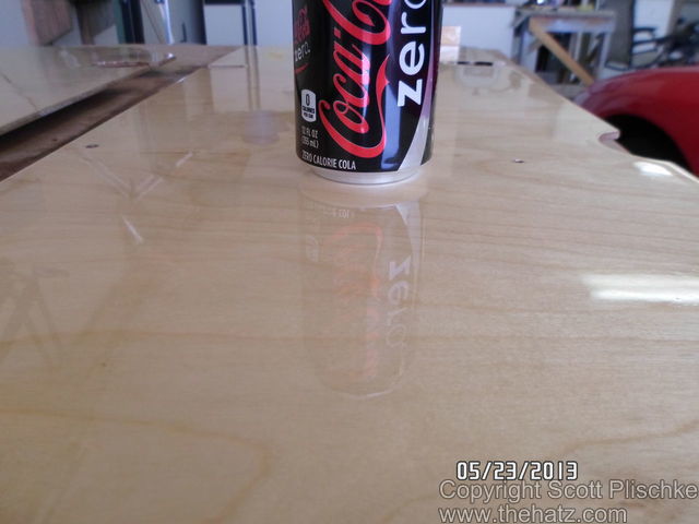

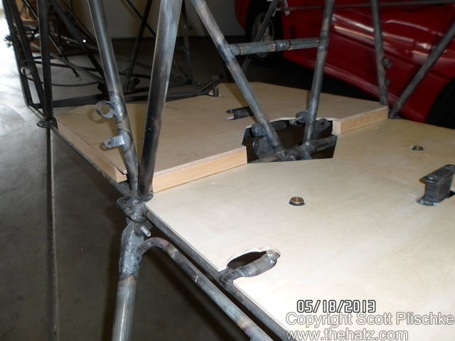

I just finished cutting the finishing the floor boards. It was a bit tedious work but I enjoyed it. The EV-400 Epoxy varnish really shines!
Floor board ready for sanding and finishing.
Polyfiber EV-400 really shines.

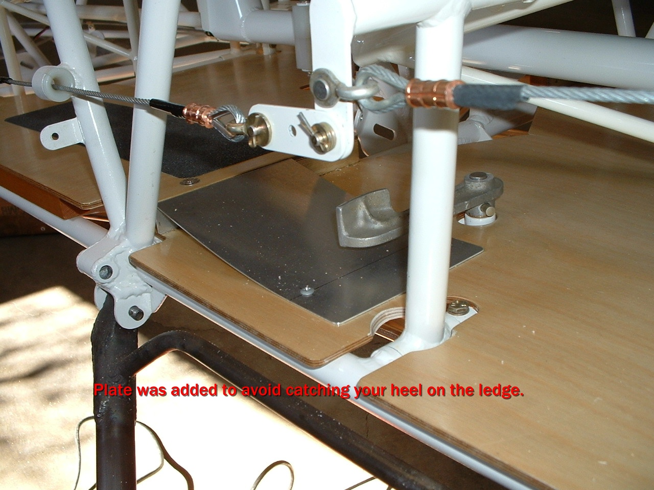

Here is a suggestion that worth adding on the Classic with the stepped floor boards.
Heel Plate01 03-06-05.jpg (388.1 KiB) Viewed 4434 times
Re: HC #86 Update
Great idea and easy to implement. Thanks!

Can anyone explain the reason that the floor is higher in the rear of the Classic. To me the step seems to create a problem with the ruder pedals. I like the ramp suggestion but why not just make both floors the same elevation. Is there any interference that I am not seeing?
Re: HC #86 Update
The raised floor provides clearance for the aileron push tubes which run under the floor.
