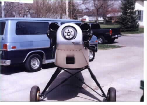

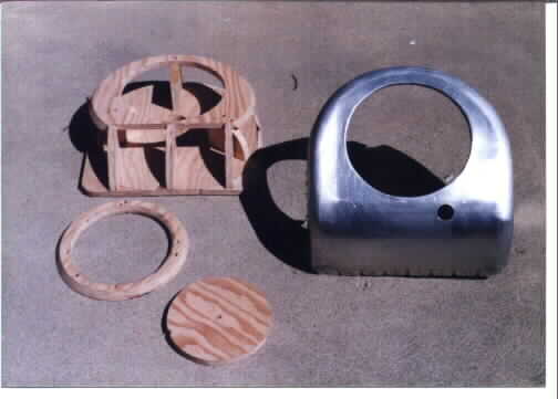

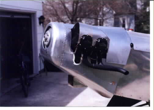

I have an O-290 with a starter, generator and ring gear fitted with an open cowl.
Attached are some pictures of my installation. The nose bowl was patterned off of a Curtis Robin nose bowl and an article in Sport Aviation, or Vintage, featured how the restorer was making his new nose bowl. The nose bowl is three pieces welded together. There are two sides, starting in the middle at the top and going to the curve at the bottom. The front is on piece with a stiffener lip in the ring gear cut out.
Hope this helps.
Hope this helps.
