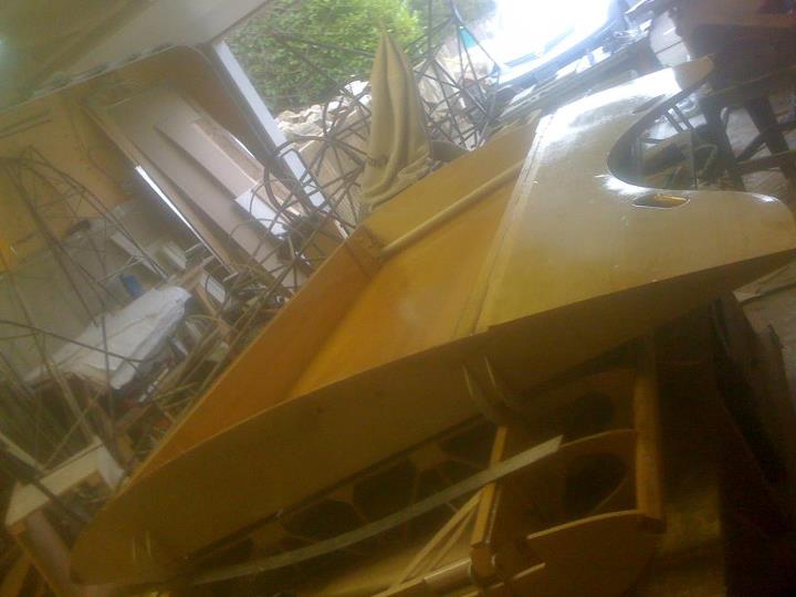

Re: Center Section Material
Hi, if you go to the builders page and go down to my pictures, 637, in the last row there is a good picture of my center section. The floor is 1/4" birch ply and the rear of the spar I used 1/8". If any questions you can e-mail me at j-jpink@bresnan.net.
Jim Pinkerton
Jim Pinkerton
I used all birch plywood. For the tank moldings and handholds I used spruce. Mahogany for the bow. I used 1/16" birch for all gussets. Came out real nice.
