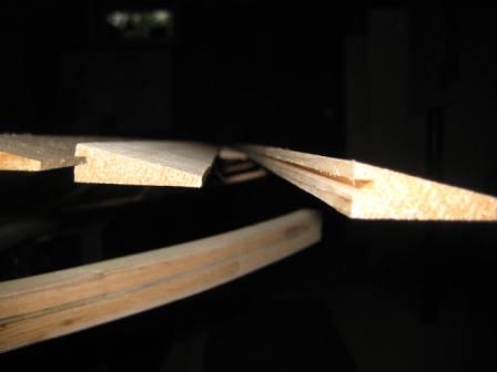

Trailing edge material.
I made trailing edge material from sitka. It has a triangular cross section and a 1/8 " groove routed the entire length on the 'base or shortest' side of the triangle.

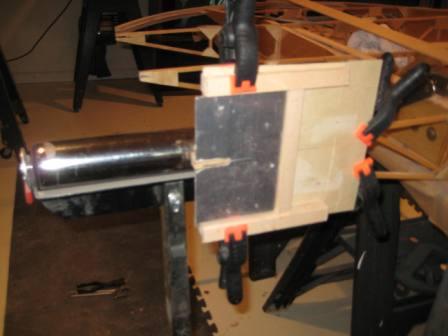

Router jig for cutting slots in trailing edge.
I used a router to cut a slot in the trailing edge of each wing rib and made 'trapezoidal biscuits' to join the trailing edge with the tail end of each wing rib.

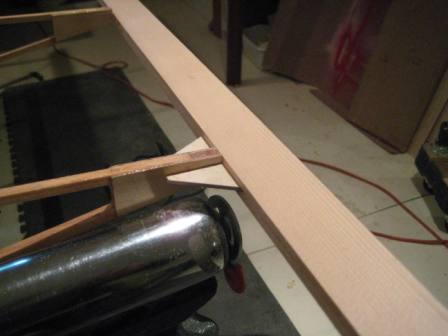

Trailing edge, rib and 'trapezoidal biscuit'.
The biscuits were inserted into the wing rib slots with T-88 and the base of the trapezoid was glue into the groove on the trailing edge again with T-88. See the pictures.
