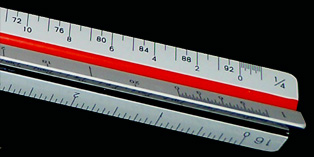

If you haven't already done so, I would strongly recommend you pick up an architects scale like this. You can find them at Staples, Office MAx, etc and are indespensible when determining length, width diameter, etc. on the plans and will help answer questions such as the 3/4 vs. 7/8 as you can measure this on the plans with a good scale.

Thanks Doug. I had tried using a ruler to measure the drawing, but I wasn't sure if it would be accurate, but I'll use that method and get at it again. BTW, I'm posting my project progress here: http://ImageEvent.com/hatz
