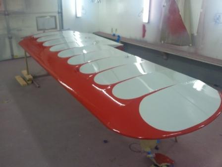

As most know. I built all aluminum wings (spar, ribs, leading edge). Here is the finished product. Finished wing weighs in at 60 pounds. I am curious as to how this compares to the wood wing?

Hey Michael,
That wing looks really nice, beautiful scallops! We understand it is a lower wing (bracket can just be seen). Does this weight include the aileron and control tube as well? Will note our wings weight when completed.
Re: Completed all alum wing
Thanks. Yes lower wing. Includes control rod but not aeileron.

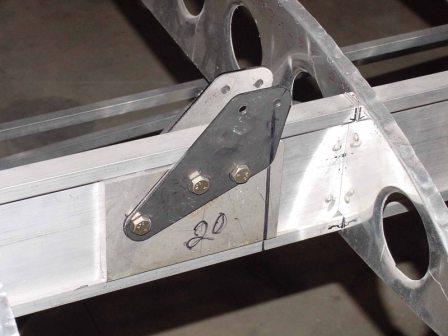

I am going to try and upload some pics.
N838MM
Wing 1.JPG (28.78 KiB) Viewed 4233 times

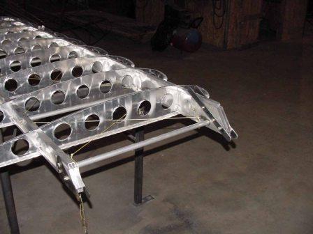

Picture 2
Wing 4.JPG (31.6 KiB) Viewed 4233 times

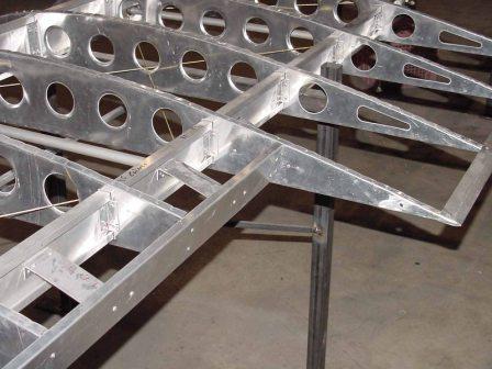

Pic 3
Wing 7.JPG (23.88 KiB) Viewed 4233 times

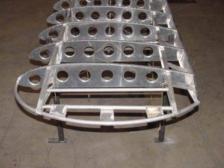

Pic 4
Wing Attachment.jpg (25.03 KiB) Viewed 4233 times

mmcgrew wrote:Pic 3
Thank you kindly. I am impressed by all the work. I am curious about this one photo though. In picture three you show a lower wing fitting and was wondering if the shim block is held to the spar by anything other than the three fitting through bolts?
Thanks again,
Michel.
P.S.: Those wing bows must have been a %$#^$ to bend precisely.
