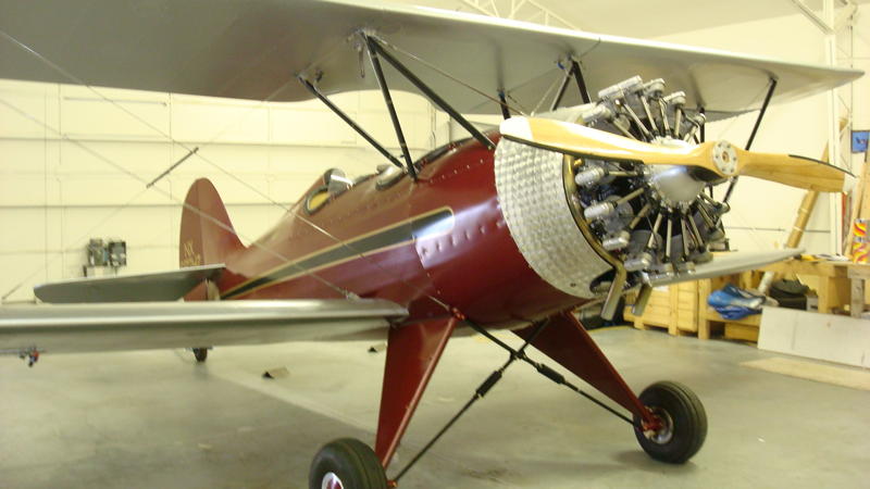

Earlier this week Carol and David Foley from Tulsa came to Logan to visit. They have a CB-1 but the Classic has caught their interest along with that of their niece who aquired a project recently. Their main question was how to accomodate a Rotek 3600 after the airframe had been completed. We sorta concluded that the lowering of the thrust line could still be accomplished but the shape of the cowling would be a little different than mine. The difference being that the fuselage formers were reshaped to follow the lowered thrust line, putting the maximum width at the middle of the firewall which is more circular that on the plans.

attached are some pics from the visit to Logan by Dave & Carol Foley

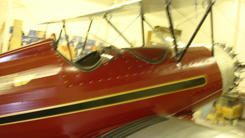

Dang thats nice looking!!
Sure would like to know how you fabricated that front cockpit cover...any tips?

Right Doug, sorry if I wasn't clear...although I do like the cowling as well. I was wondering how to add a front cockpit cover if I had a padded combing around it. I looks as though you solved that problem.

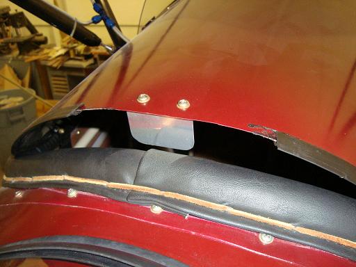

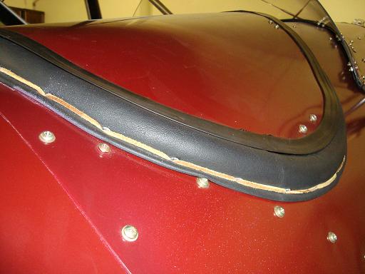

When cutting the cockpit hole, the piece removed was saved intact. The outer edge was lined with an "h" moulding. A pair of strap fittings from West Marine were attached to the cover more or less at the widest part and inboard of the edge enough to clear the padded combing. The cover is held in place with a couple of 1" straps with velcro attached running down through the plywood former adjacent to the front seat. A light aluminum "L" bracket was formed and riveted toward the rear of the cover to maintain the longitudinal position. There does not seem to be any air load on the cover. It does make the rear cockpit less breazy. The first few flights were without the cover and the draft brought the dust that had eluded the vacuum during construction up into my face.

Thanks John. Could you post a couple pictures showing the installation? Maybe a closeup of it installed and a couple of the backside of the cover and the method of attachment? Sounds like an idea I may try myself when I get to that point.

Pictures of the front cockpit cover.
