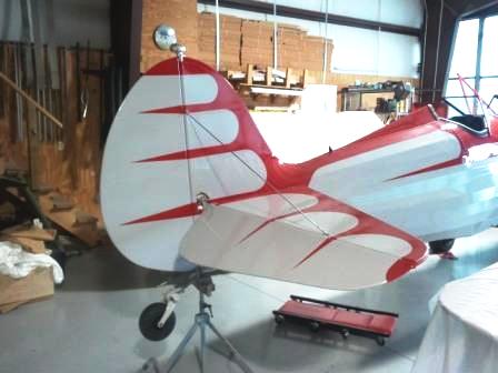

At this point there is a lot to be said about a one color airplane!!!!
N838MM
N838MM
