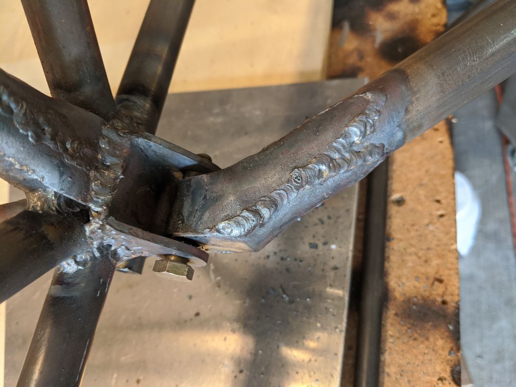

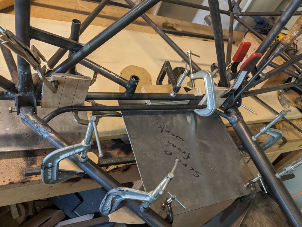

Here are a couple of pics I snapped as I am making progress with the landing gear: This has been one of the more challenging part to jig-up, so maybe these pics will help others. A guy can hope.

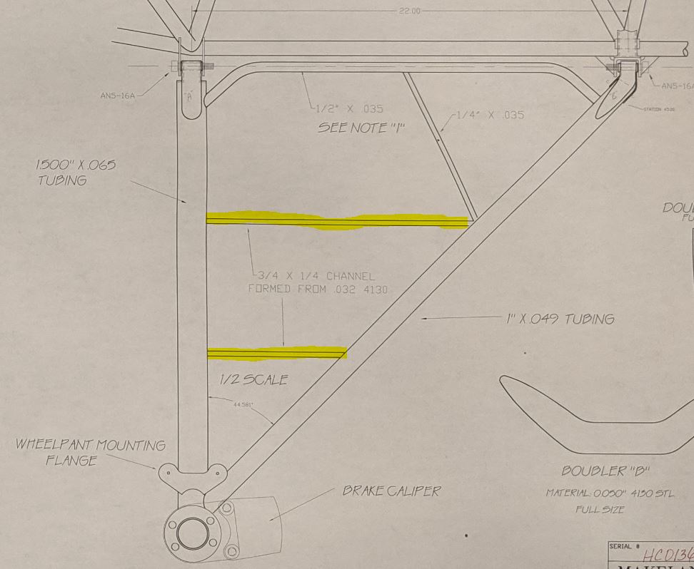

Now that I have both sides done to the point where the triangle shape is there, I am wondering about the rest of the parts that allow the gear legs (once covered) to have a more aerodynamic shape - a couple of formed channels placed horizontally between the two vertical members: I am not sure I am a fan. I might just leave the gear legs "naked".
Isn't that the original CB design? What do others think?

A solution is to make a plywood former the shape you want and then bolt them to the called for channels marked in yellow in your drawing.

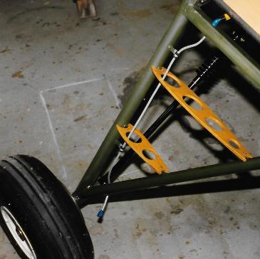

Here's what I did.
- LandingGearShape.jpg (22.3 KiB) Viewed 2889 times
- Posts: 101
Re: Gear legs: progress and question
JBMoore wrote:Here's what I did.
Yeah, like that!
