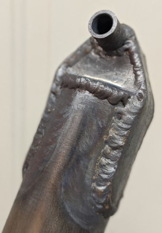

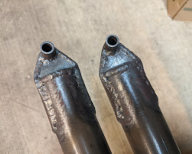

And then there were two!
Re: Picture of the week(end)
Nice work!

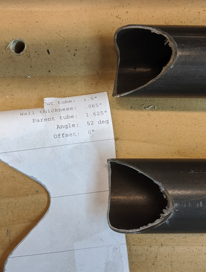

Here is the other end of those two gear leg tubes, cut using the pattern generated by the coping website:
http://www.metalgeek.com/static/cope.pcgi
