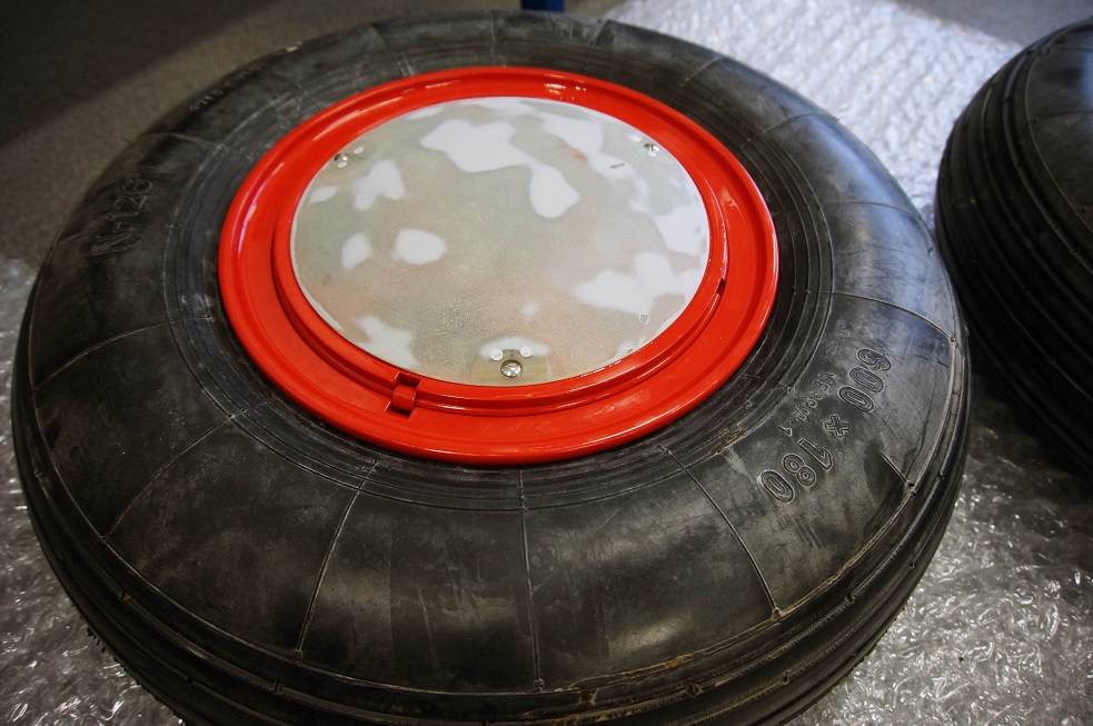

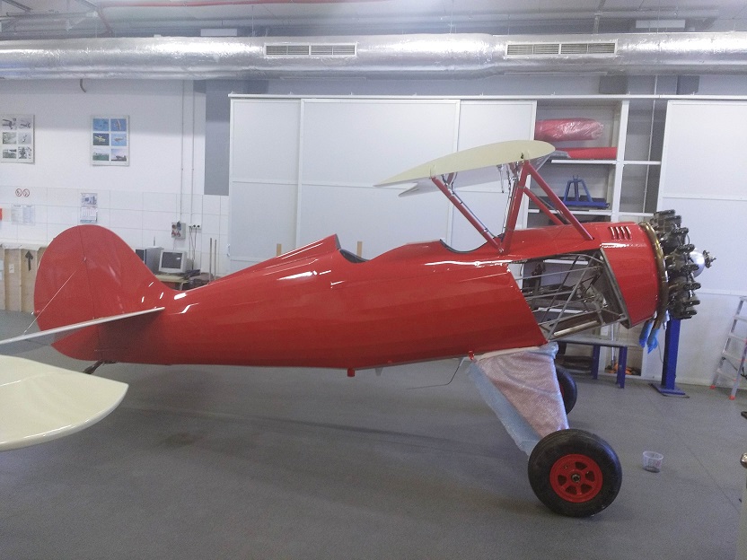

I use wheels 600x180mm (bigger than from plans). Thrust line: 9". Prop: 84". Landing gear shortened to 26". Estimated prop clearance approx 12" (final measurement soon).
Wojtek
Wojtek

Doug and Wojtek,
Many thanks for your comments and info.
Wojtek love your plane,
Thanks Fraser
Thanks Fraser
