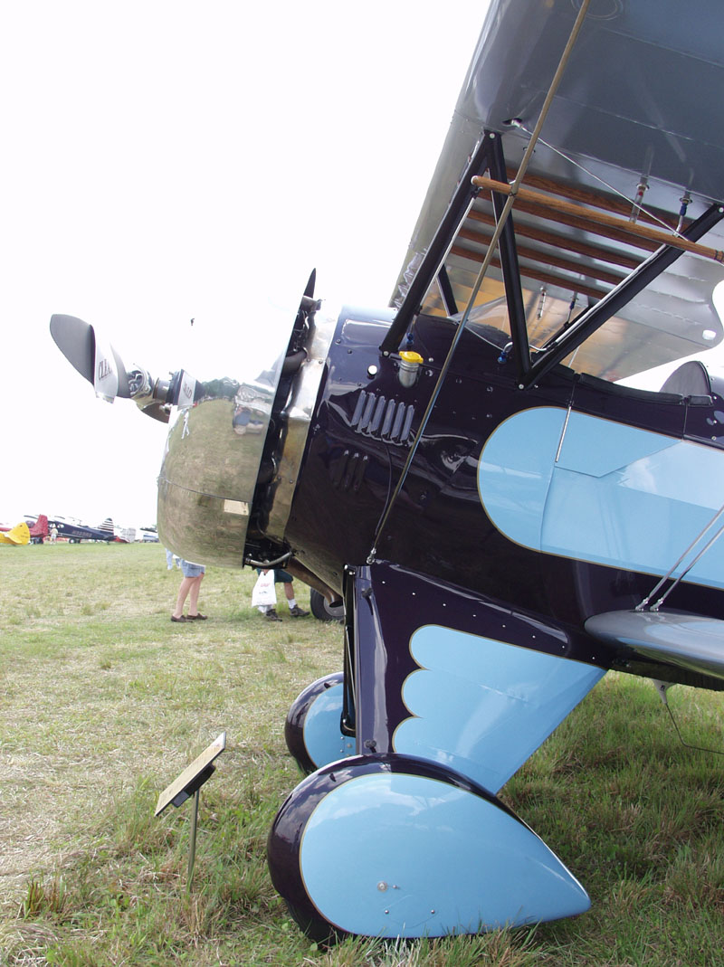

HI Everyone, I've been exploring options for a speedring cowl for my Hatz for the Rotec. I contacted the KC Dawn Patrol a couple years ago and got directed to Airdrome Aeroplanes and then eventually to United Metal Spinning of Kansas City who apparently makes their cowls. After letting this sit on the back burner I finally decided to get back to it and see what it would take. The short answer is; the speedring is very affordable, but the initial tooling costs are steep. The quote I received was $375.00 for the cowl and $3,475.91 for the tooling.
So, my question to the group is: Is anyone interested in a speedring and helping spread out the tooling cost across multiple orders? Future builders would obviously benefit from our initial work. If I did this alone I would be paying $3850.00, but if 1 or 2 others joined in it would start to make it much more reasonable. The quote was for the speedring complete with rolled wire leading edge and folded training edge. It does not include any mounting hardware; that piece we would have to do ourselves.
Thoughts?
Thoughts?

Ed, that sounds great. Let's see if we can get a couple more. Last time I checked with Hans they did not have enough people... I think he was looking for 6, United Metal Spinning does not have a limit.

Hans quoted me 1800 CHF (Swiss Franc) which is about $1850 USD. I understand the desire to have the mounting hardware. Once nice aspect about The United Metal Spinning option is that it is a company that does this full time so they can produce when needed and easily deal with any problems. Hans did a beautiful job and really appreciate his offer to make them, but it is still a private operation and he needs enough to make it worth it for him (6 I believe... which I understand)... he doesn't do this for a living. In the long run (for future builders, not for us) the cost from a domestic source would also be much less.
