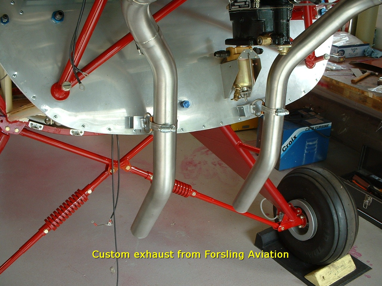

I purchased the exhaust in 2006 from Forsling Aviation and am just getting around to mounting it. A beautiful piece of welding in stainless steel. Small wire cable loops swaged with a copper band came with the exhaust and I am wondering if any builders have photos of how they used them to provide support for the two 'down pipes'. I have an idea but pictures would sure help.
Thanks.

I pop riveted two 1 inch square pieces of hardware store aluminum to the bottom of the firewall and attached the cables from Forsling to those. They have held up just fine.
Exhaust System09 09-06-07.jpg.JPG (420.26 KiB) Viewed 3768 times

I called John Forsling and he helped. Your picture really helps.
Thanks
