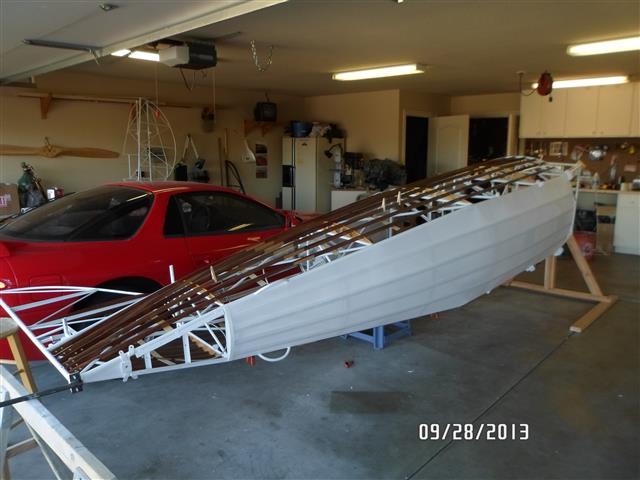

Just thought I'd share a picture of my 'Classic' being covered. Bottom piece attached. Still much more to go. Incidentally, I'm using the Air-Tech System.
- SAM_0237.JPG (68.65 KiB) Viewed 5961 times

Wow! Congrats on the milestone! Keep us posted on how you make out with the Airtech system. I'm considering the same thing.
Re: Covering started
I can't tell you how motivating I find these builder update pictures!
Good job!
Keep 'em coming.

Thanks. I'll post more pictures as progress continues.
I'm hoping the Air-Tech System works as well for me as it did for Ron Sieck on his award winning Classic. So far I can only comment on the glue and it's not much different than Poly-Tak except you must reduce it a lot.
