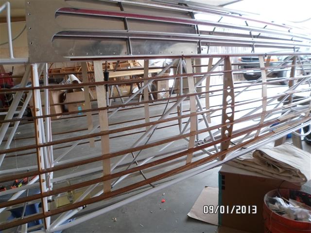

Fuselage78 03-16-07.jpg.JPG (325.96 KiB) Viewed 7141 times
Hi Doug,
We cut 1 inch strips of 1/16 plywood and glued them from the top longeron across all the stringers and down to the bottom longeron. This held them in place very nice. We used two on each side behind the cockpit.
John Hanson HC-012

Re: Keeping stringers straight
Hi John,
The 1/16" ply vertical supports worked great. I had to use two per bay but I managed to get the stringers nice and straight.
Again, thanks for the idea.
Post by TangoWhiskey »
splischke wrote:Hi John,
Scott, did you just clamp those in place as the glue set up, or use some other method?
I used cyanoacrylate to temporarily hold a ply strip to a stringer. The CA bond isn't very good but this worked in my favor since I was able to relocate the stringer if it was off. Once the entire stringer was straight, I epoxied pieces of triangular spruce stock to make the bond more permanent. The picture above doesn't show these spruce pieces. I hope this makes sense.
splischke wrote:I used cyanoacrylate to temporarily hold a ply strip to a stringer. The CA bond isn't very good but this worked in my favor since I was able to relocate the stringer if it was off. Once the entire stringer was straight, I epoxied pieces of triangular spruce stock to make the bond more permanent. The picture above doesn't show these spruce pieces. I hope this makes sense.
Makes perfect sense! Thanks. I was thinking that clamps might cause more bending/twisting, so this solution makes total sense... Simple and effective.
