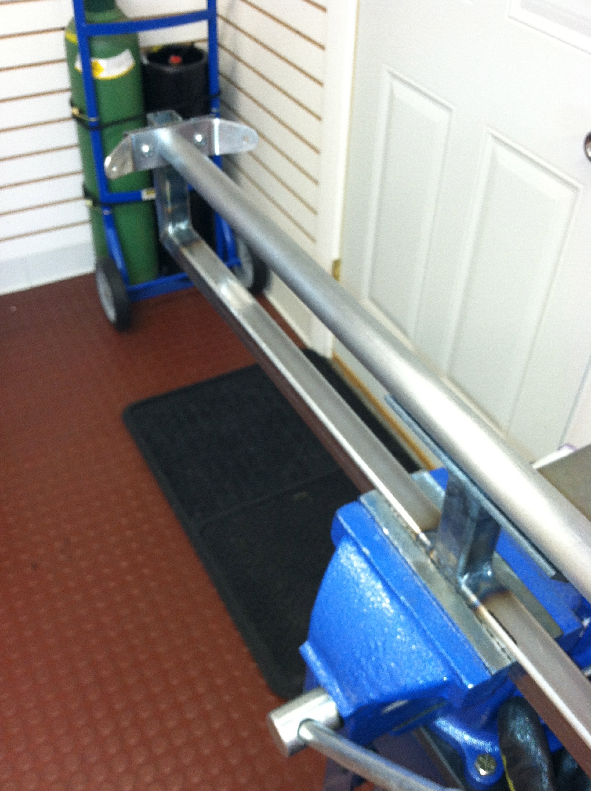

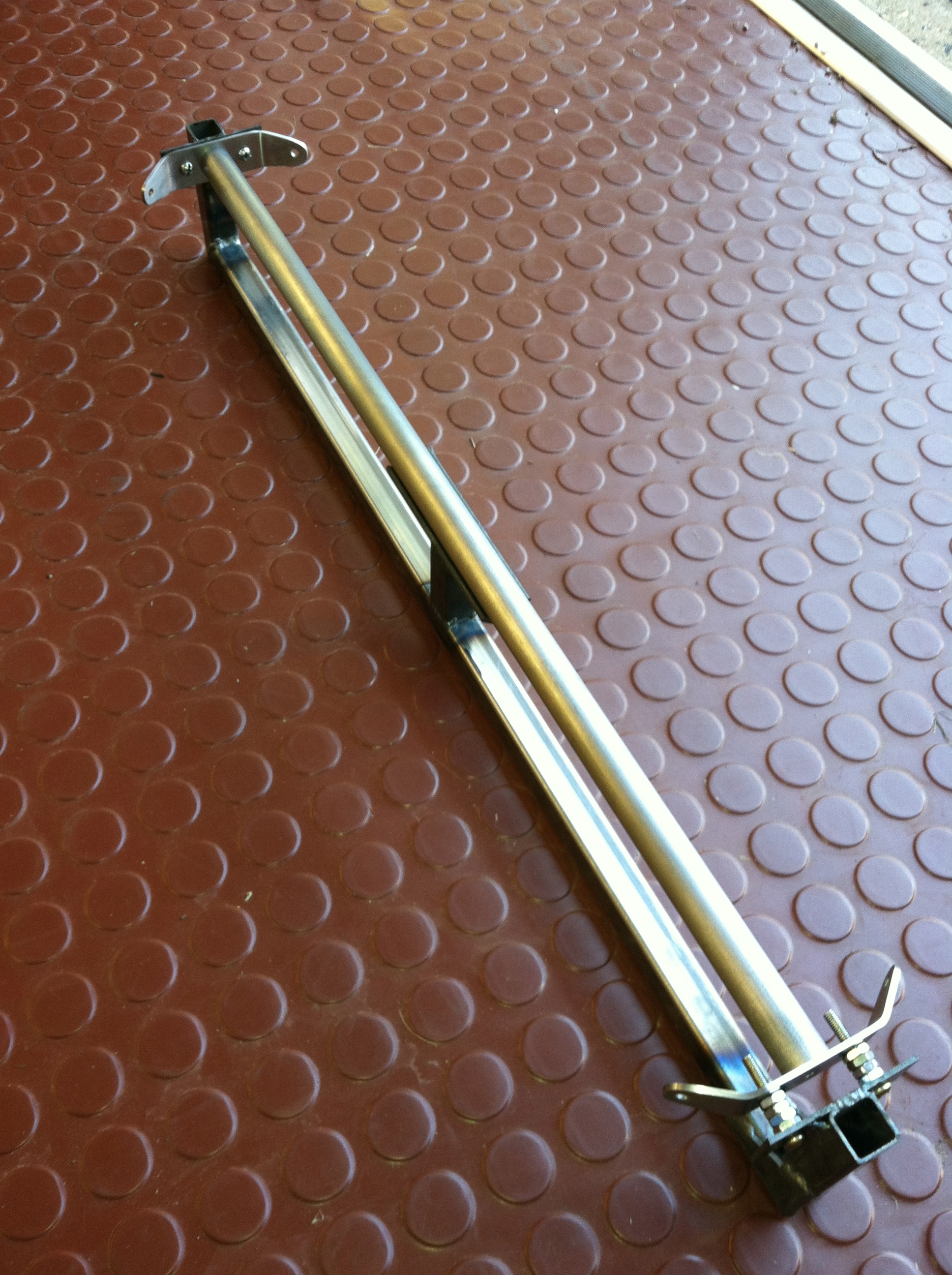

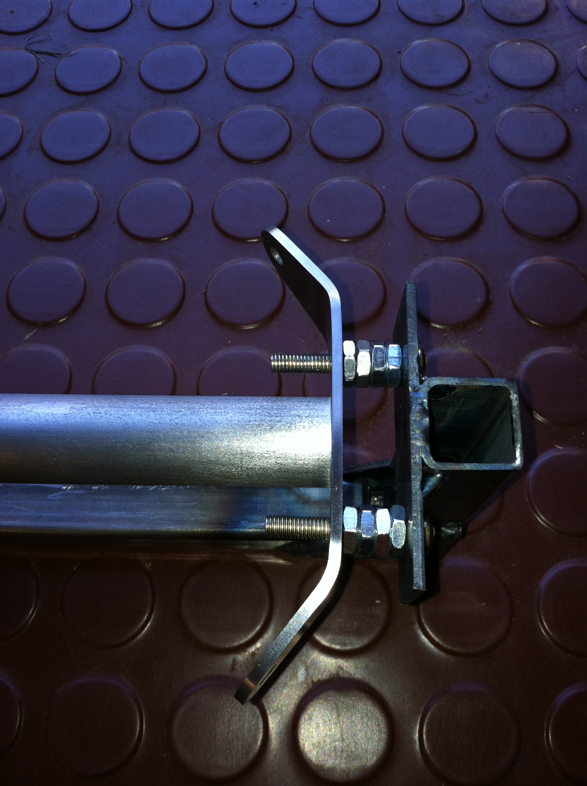

Attached are pictures of my homemade jig for the compression tubes. It is sized for the longest tubes (TB-2), and I simply used nuts to adjust for a smaller size when welding the shorter tubes. It's made from a length of square tubing from the Home Depot, and a couple of flat scraps. It took a couple of hours to build, and worked great for all of my compression tubes.
Good luck,

Nice jig, Mark. I think I'll use that when I get around to welding my tubes.

Great looking jig.
