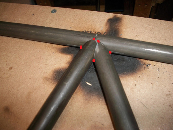

You mention "clamping everything so it won't move". Does that mean you do not have any blocks holding the pieces in place/alignment on the table? The blocking should be sufficient to hold everything in place and provide an easy way to build identical sides.
I did not wet the bench. Using MDF (mistake) was ok, but wetting it would cause it to break down after a while. I didn't worry about scorching the bench. You're only there for a couple seconds. In some spots I used a thin sheet of scrap aluminum as a heat shield which worked well. I slid it under the joint before I tacked it (which I did not do in this photo).
For any joint I tacked anywhere the tubes touched. See photo... When I took the side out of the jig I also turned it over and took the time to tack the other side.
