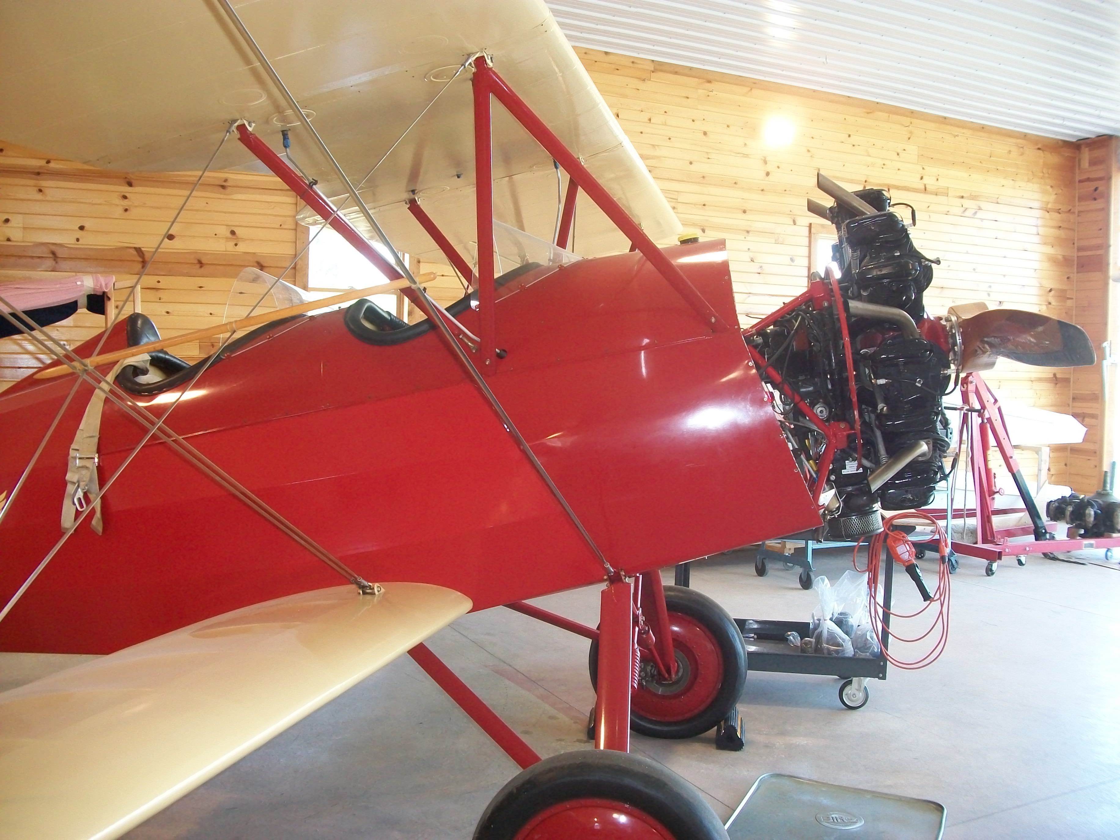

Have you talked to Bill Rusk? If not, I would strongly suggest you do. He owned Mehlin's Hatz flew it more than anyone. He's still on this forum and also on the Supercub forum so his contact info is around. No one know the installation better than him. You're going to want to pay a bit more attention to weight and engine position.
He's building a Cub and is chronicling it on the Supercub forum, but on Page 9 of his thread are some shots of him working on the engine:
http://www.supercub.org/forum/showthrea ... -Cub/page9

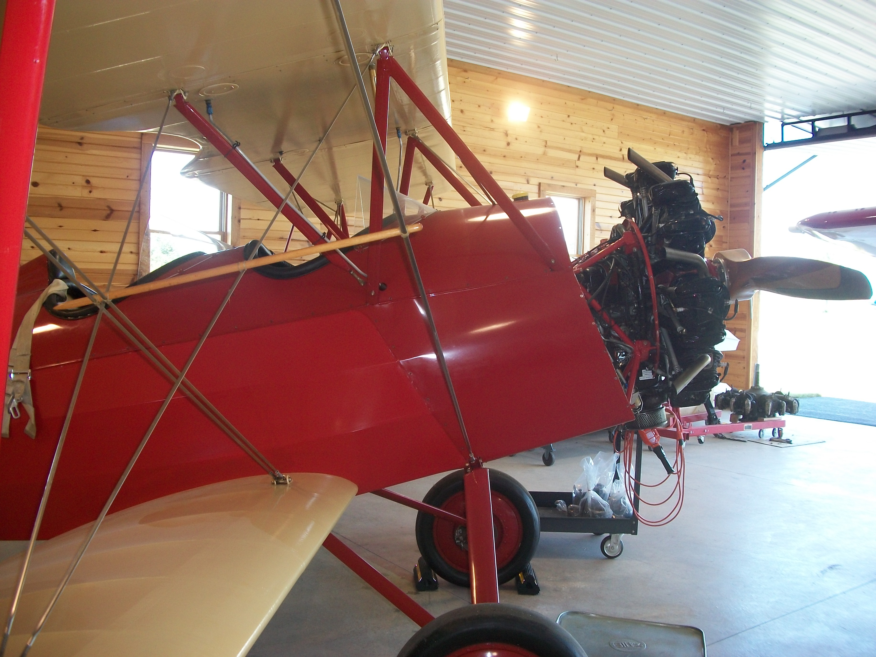

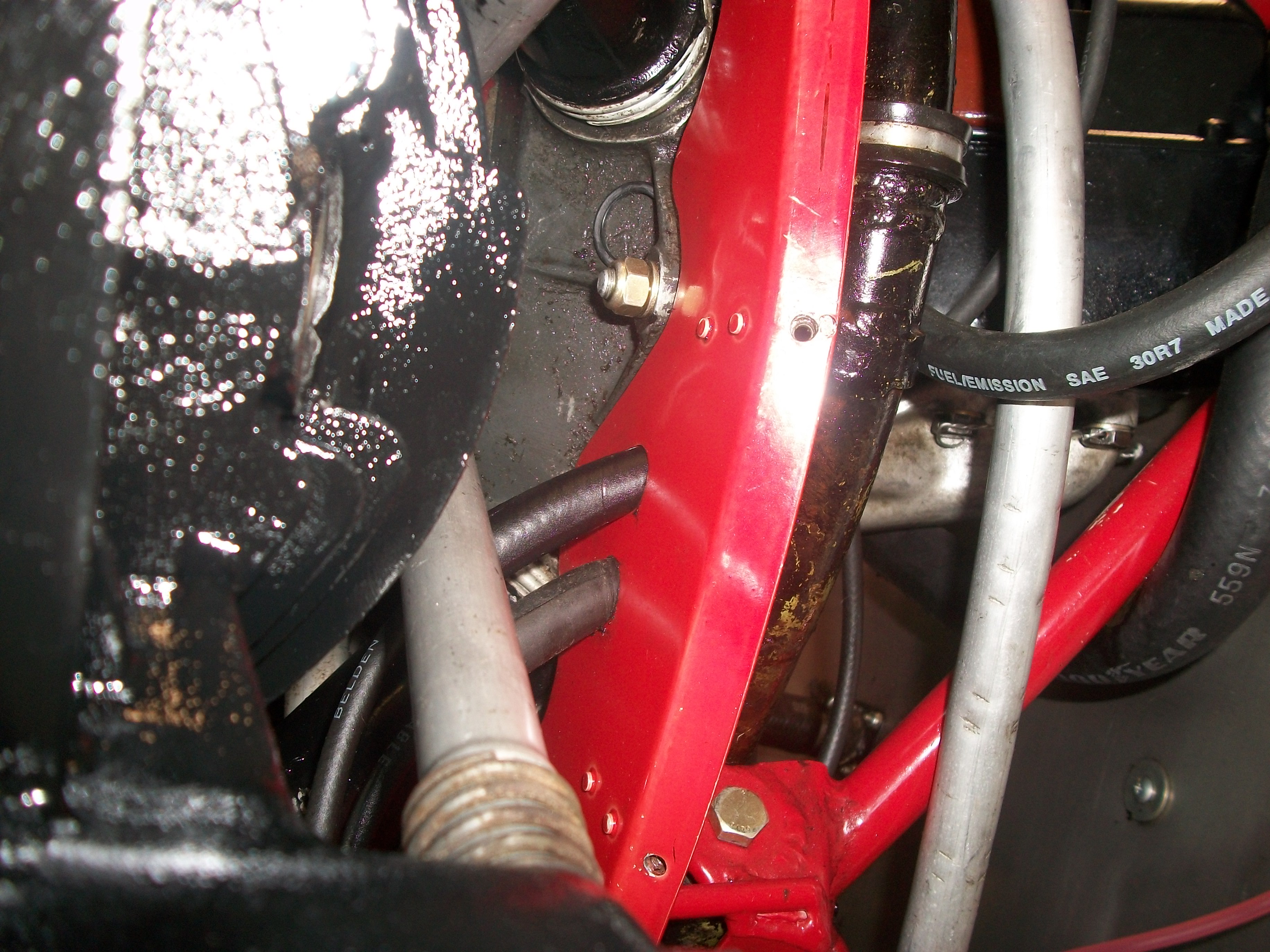

Also, here are a couple shots I took when I visited Bill in 2010 (sorry for the giant pics):
- 100_1188.JPG (1.12 MiB) Viewed 4586 times
- 100_1183.JPG (1.74 MiB) Viewed 4586 times

Thank you so much Doug. That is exactly what I was looking for. I have met Bill who was generous enough to let me fly his Warner powered Hatz. However, I wasn't able to get a look at the engine mounting at the time. These pictures give me some good insight. I still may convert what Mehlin did to a swing out mount.
I couldn't make up my mind between a Warner or a Lycoming as I was starting the fuselage, so I just made it to plans. Now that it is welded, I'll just have to put the engine as far back as possible, and add weight in the tail to compensate for the extra engine and oil weight.

No problem. As mentioned above and in another thread, Mehlin extended the fuselage 8" all of which was behind the rear 'pit. For quite some time Bill thought there was weight added to the tail of the Hatz to compensate for the Warner, but I asked him to confirm this for me one day and come to find out there was NO weight in the tail (not sure how much the extra 8" helped). Mehlin pulled the engine aft as much as he could and built it very light (no electrical system).
I agree with you on the swing out engine mount; I plan on doing the same thing for the Rotec.

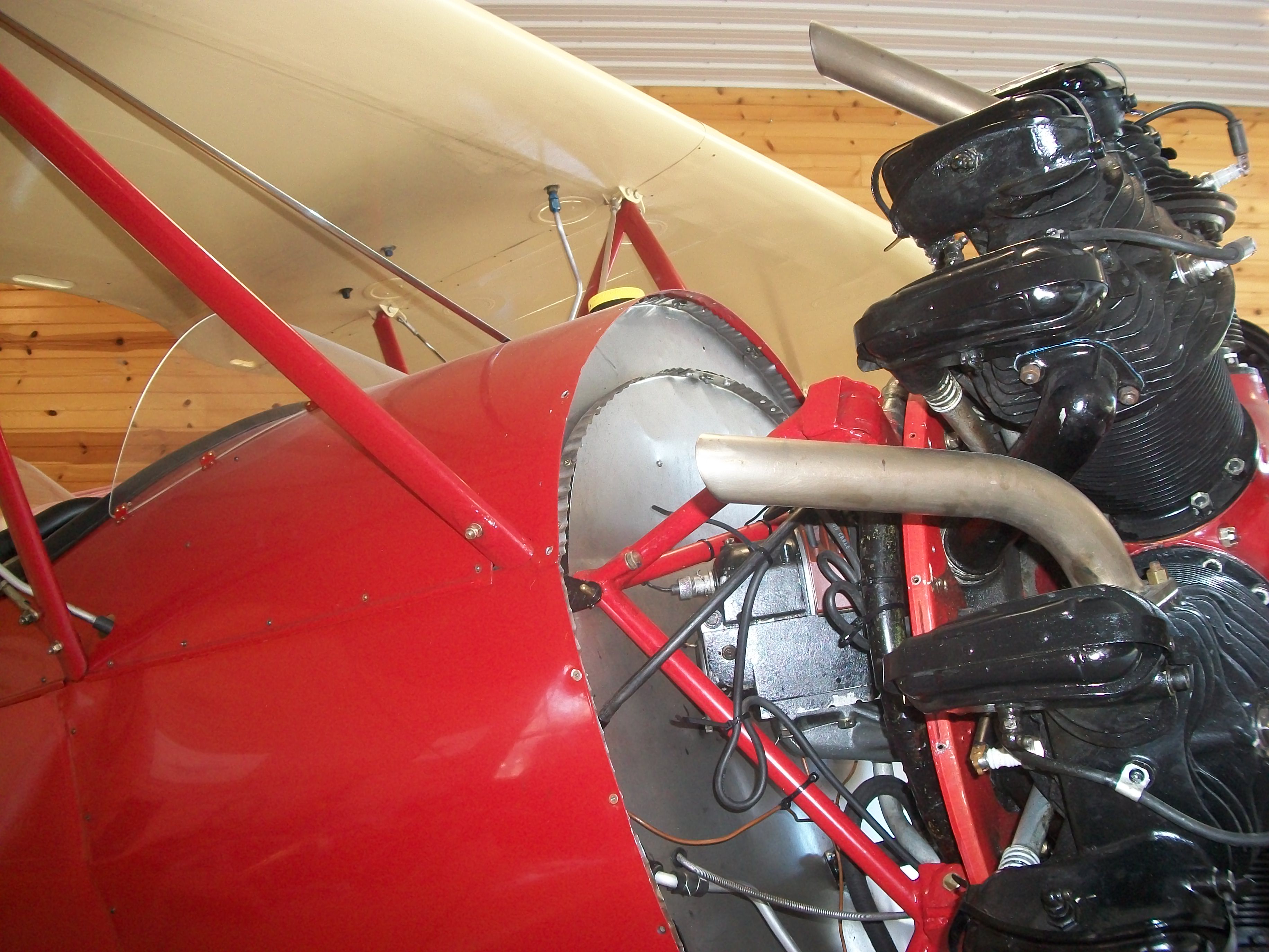

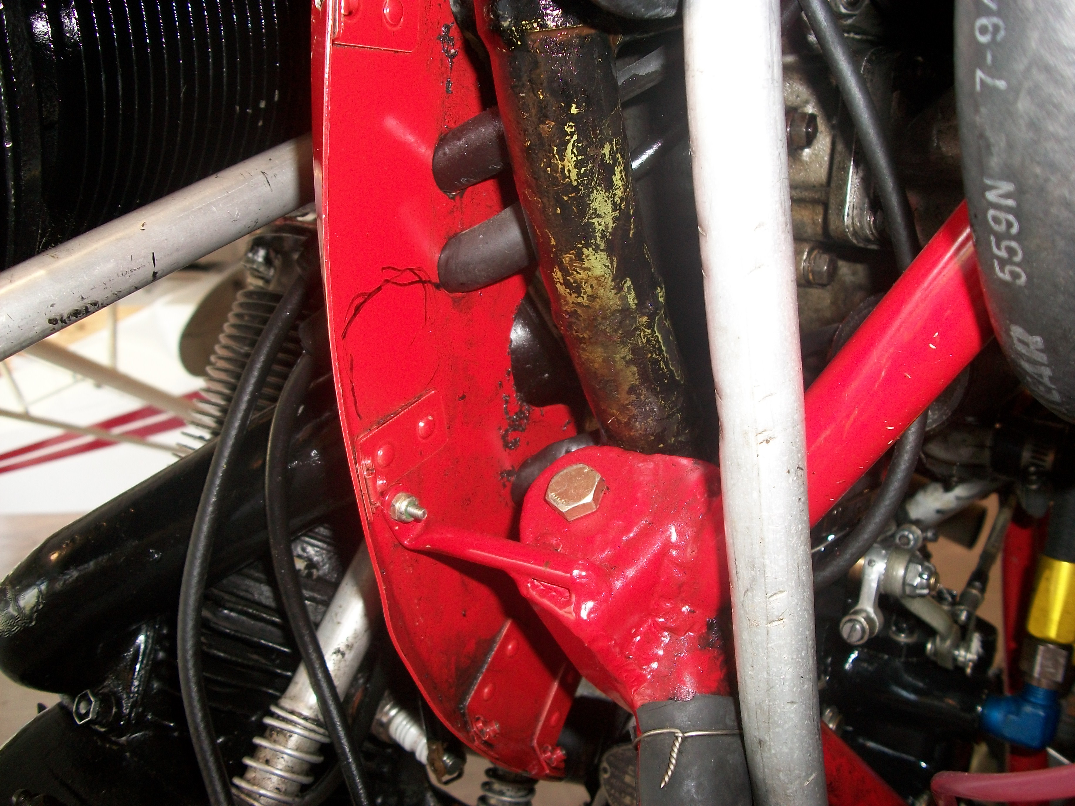

Couple more pics:
- 100_1182.JPG (1.26 MiB) Viewed 4571 times
- 100_1193.JPG (1.83 MiB) Viewed 4571 times
- 100_1195.JPG (1.69 MiB) Viewed 4571 times

Congratulations on your ambition to have an actual Warner powered Hatz. I had considerable interest in the same, as I think the grease blowing back on your goggles would be so cool. Due to the complications with the weight and balance (primarily balance) and the fact my fuselage was done I chickened out. (I'm doing the Rotec thing.)

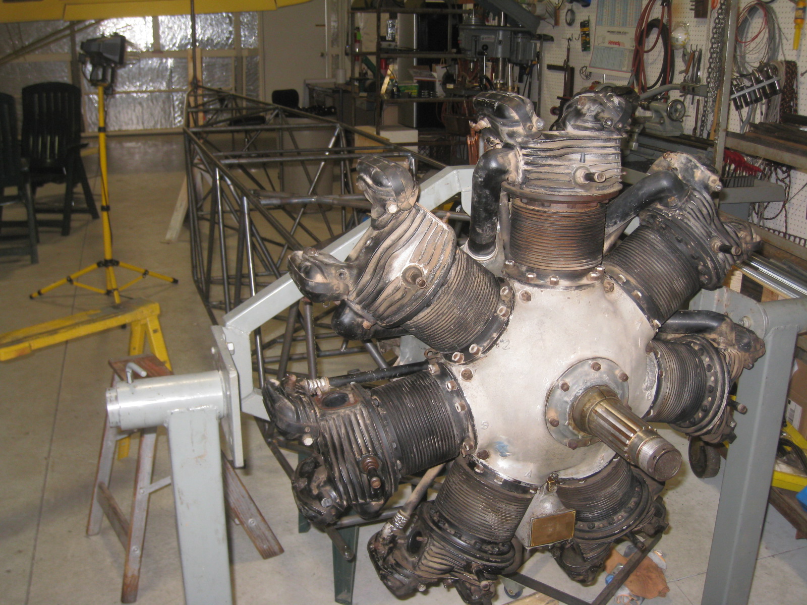

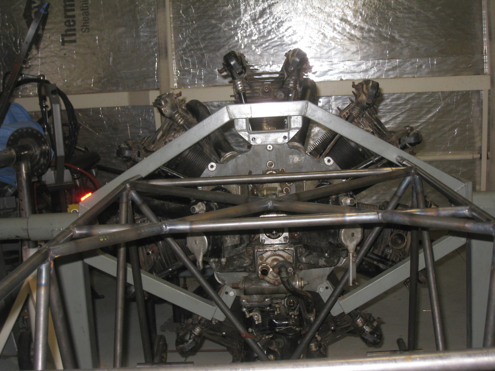

Here are a couple of pictures of the engine placed at the front of the fuselage.
Of course there are many other variables in each airplane, and it could be the final weight and balance ends up within tolerance without the added weight. I will just have move forward and make adjustments as things come together. This being my first homebuilt, and the engine alone providing plenty of challenge, I will stick to the plans for the most part. It probably won't look quite as period as Mehlins, and I certainly don't have the skills he most likely did.

That is going to look good. Like I said, We'll all be watching.........
