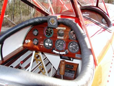

If I had it to do over - I would extend the rear panel back 1" and the front bulkhead forward 1". The instrument space (Classic) is very minimal for a full complement of instruments. My electric AI with connector was 1" too long - caused major problems. I also use the ICOM radio but mounted below the panel. See pics.
MAM
N9648B
N9648B panel.JPG (41.78 KiB) Viewed 1933 times
