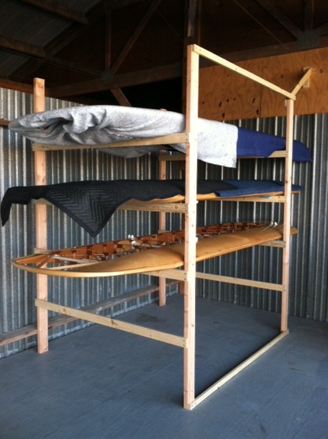

I agree with Mark ...Wings first, varnish and store. I built this simple wing rack at my hanger to store my wings while I have the last wing at home constructing and fitting the first aileron. I had the same thought too that completeing the wings first will allow a perfect fit of the wing attach fittings on the fuselage.
