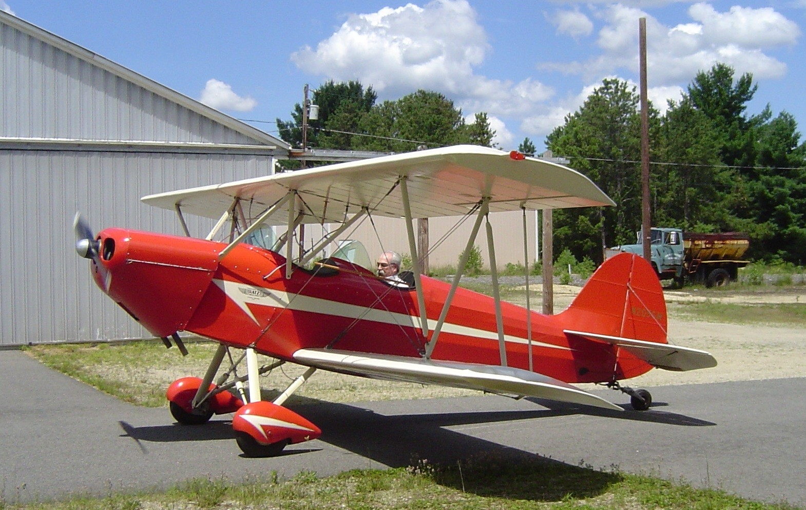

Congratulations John!
I was up to Lawrence Airport several weeks ago to visit Mickey Ricard...he told me you were almost done! Boy, you've come a long way...great job!
I still have S/N 205 out at Orange, MA. I had Doug up for a visit (he's a good guy!). I hope we can get together sometime!
Vic
Vic

Thanks Vic for the well wishes and letting us crawl over your airplane. I got some great ideas on how it should all come together such as extending the removable metal side panels on the side so i can service the brakes. I remember what you went through. If Fact I bought the brakes off Mickey. He weighed the plane too. He's been a lot of help when I had doubts. Hope tomsee you soon.
