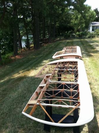

Thought I would join Doug in updating our HC progress.

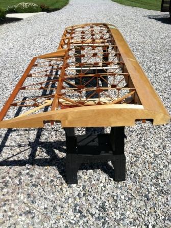

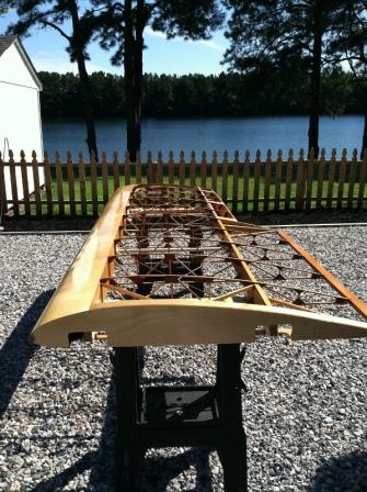

The center section is complete, all four wings are complete with the exception of varnish on the newely completed bottom wings and construction of the ailerons. I'm setting up jigs to build wood ailerons.

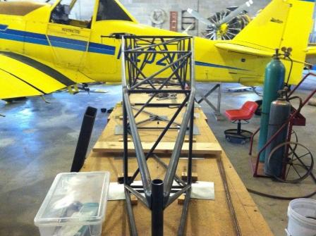

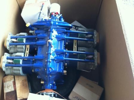

The fuselage clusters are being welded by a good friend who does beautiful work and has a ton of experience. Jeff Shoemake built my landing gear and dynafocal mount for our 0 SMOH Lycoming 0320 D3G 160 engine. I got in on the group order for the flying/landing wires and they are beautiful. I have bought our Sensenich wood prop about two years ago with 50hrs. that included the prop bolts, plate and spinner. I sent it to Sensenich to go over and certify and it returned beautifully finished and ready to mount. I hope to have the fuselage on the gear by spring and rig the wings and tail before I start covering the wings next summer.
- Top right wing (598x800).jpg (50.96 KiB) Viewed 6318 times
- Right & Left bottom wings complete (598x800).jpg (41.26 KiB) Viewed 6318 times
- Top left wing (598x800).jpg (56.65 KiB) Viewed 6318 times

- 0 SMOH 0320D3G (800x598).jpg (29.95 KiB) Viewed 6317 times
- cluster welding (800x598).jpg (40.38 KiB) Viewed 6317 times

Looks great. So does the backyard. I would love to see more pictures. With water in the back yard are you going to put it on floats?

Thank you, the hot and dry summer we have had on the east coast has been rough on our yard and the lake as well. The lake is a bit small and if it were larger, I'd be tempted for sure.

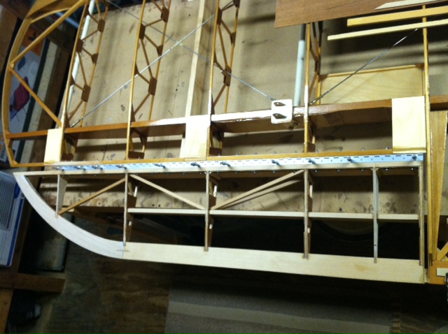

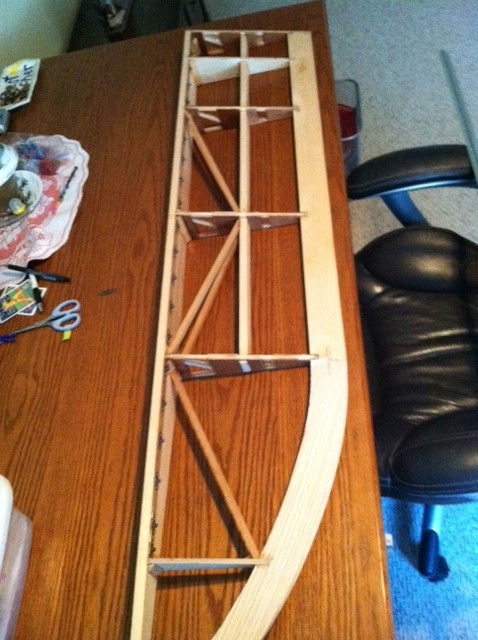

My progress has been slow too but thought I'd share my latest progress on the ailerons. I had decided that I wanted to go with the look of the very early Waco UPF-7 wood ailerons, don't think they produced very many. I'm not completely finished with his one but very close. I'm waiting to drill the holes and attach the aileron fitting and slave strut fittings until I assemble and rig the wings that way all fittings and their exact location will be determined. I will add the last 4 diagonals in the first two rib bays when that is completed.
