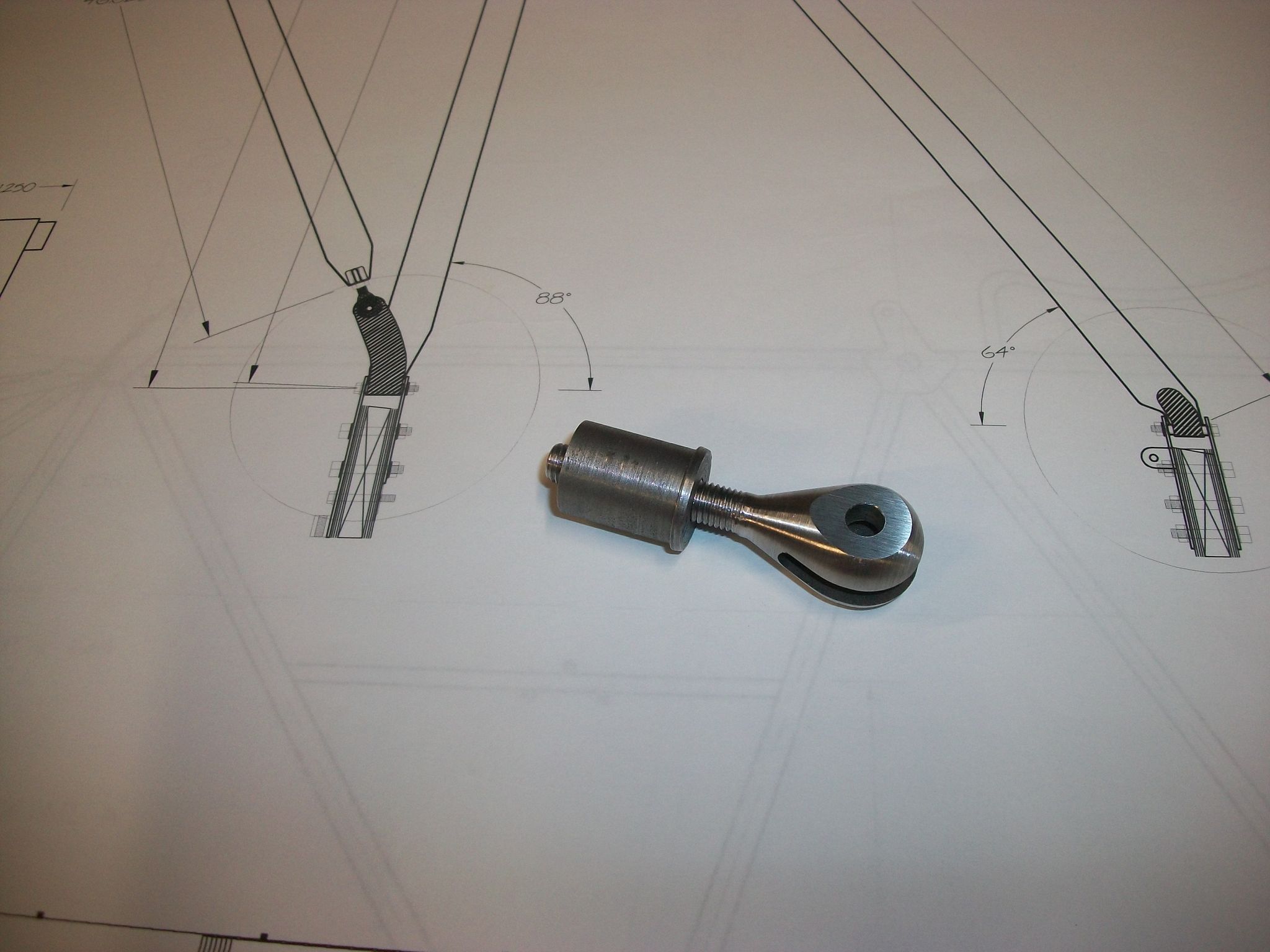

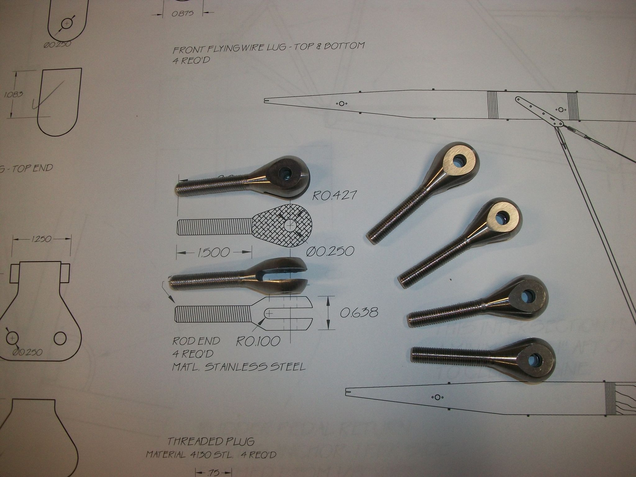

I decided a while back to start pushing for these and I received mine about two weeks ago. I held off on reporting it to the group because Carl wanted me to look them over first and, while overall the work is very nice, there are some burs on the threads from the cutting process. I've been exchanging email with Carl on this to see if anything could be done and he has been working to see if it can be dealt with. He told me he has tried three different cutting tools all with the same results. The burs are small, but noticeable. They do not seem to interfere with threading them onto their fittings as I could screw them into the threaded plugs I made with no trouble at all and no slop or play. They are probably fine, but I've asked him to see if he can eliminate them.
His shop is busy, so I would suggest that maybe others should contact him for a status if we want to move this along.
