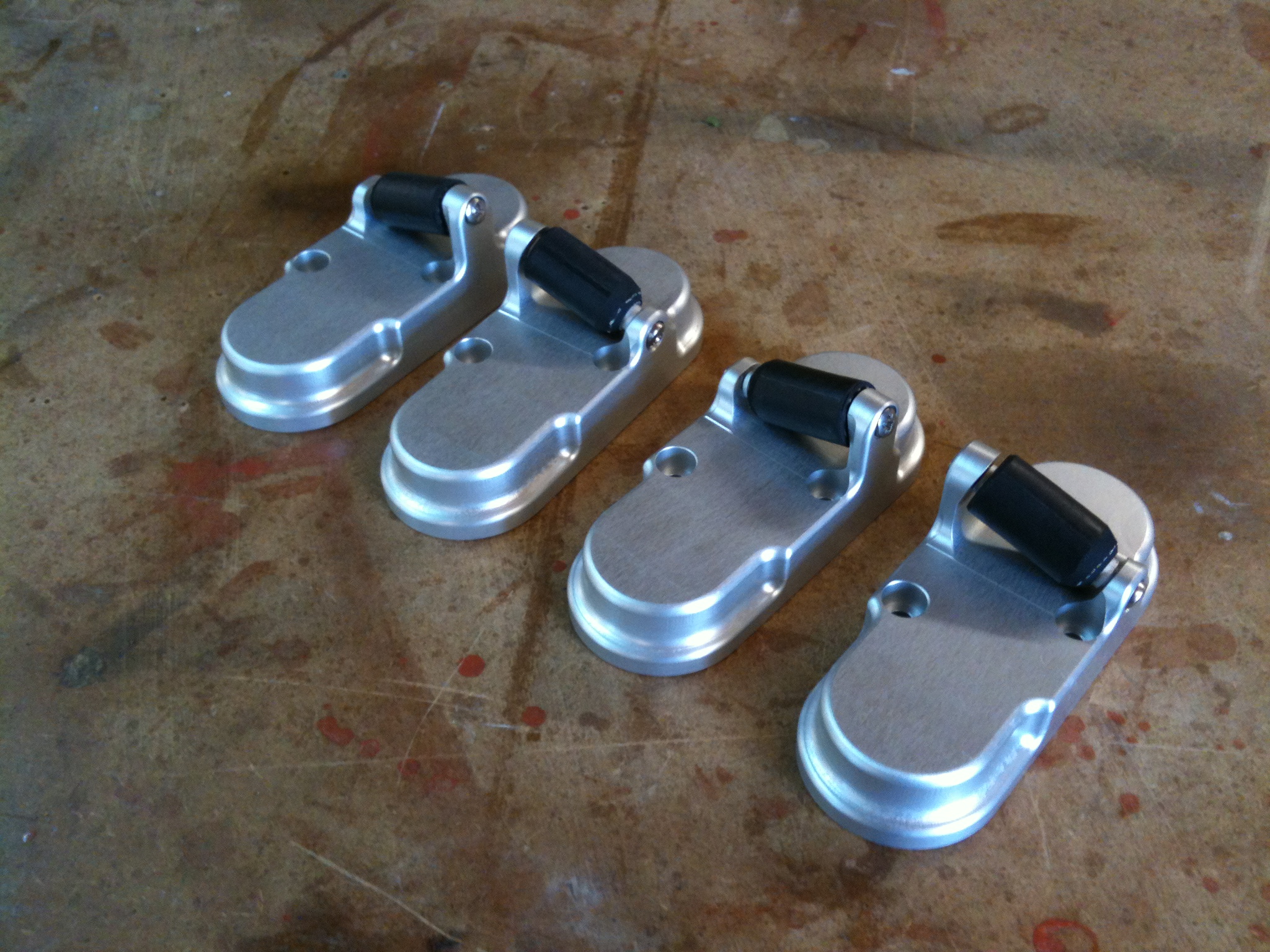

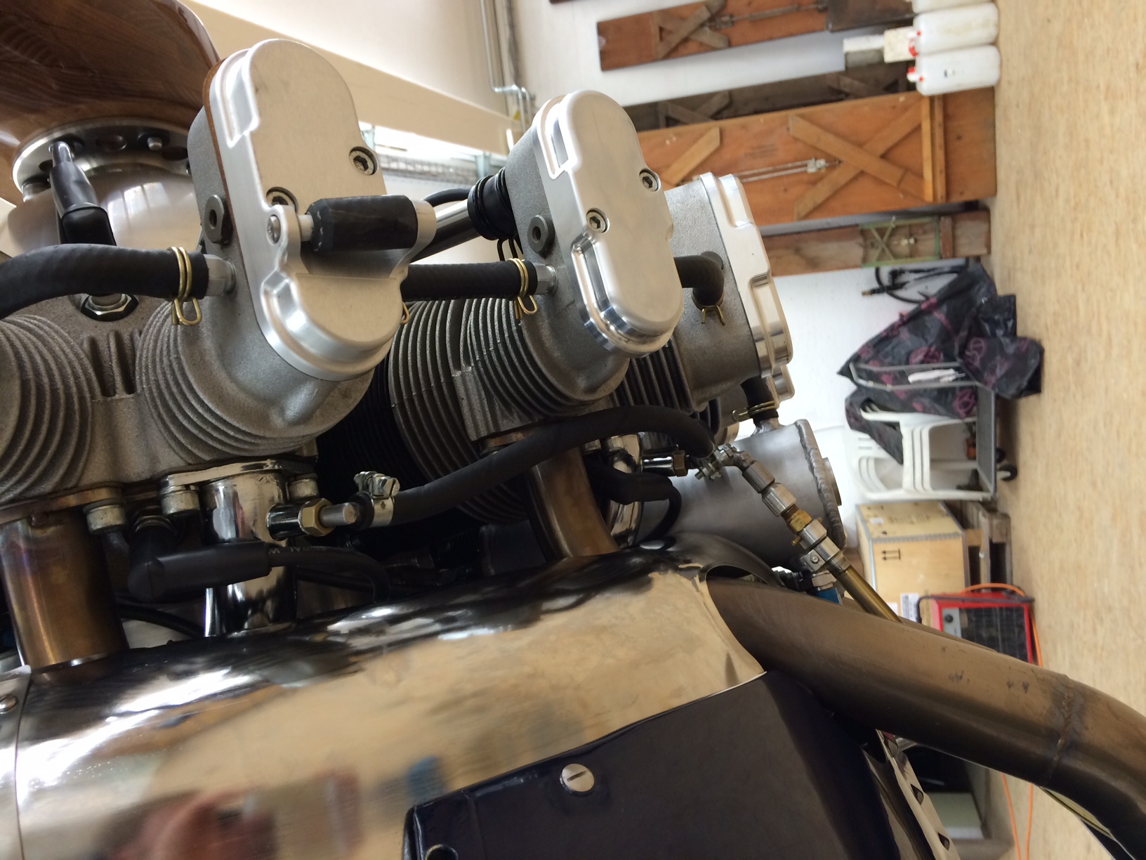

Hi all,
We have adapdet the way of mounting the Speedring basically from the Waco QCF's attachment. Our speedring is fiexd to the engine by 4 rocker covers.
Due to that, the speedring is somehow flexible between those attaching point's and diameter changes due to heat/cold condition of motor and speedring
could be regulated.
The speedring have 4 aluminum plate molds, where the 4 rubber hoses fits in.
Sam & Hans
could be regulated.
Sam & Hans
- 4 special rocker covers to take speedring
- special rocker covers

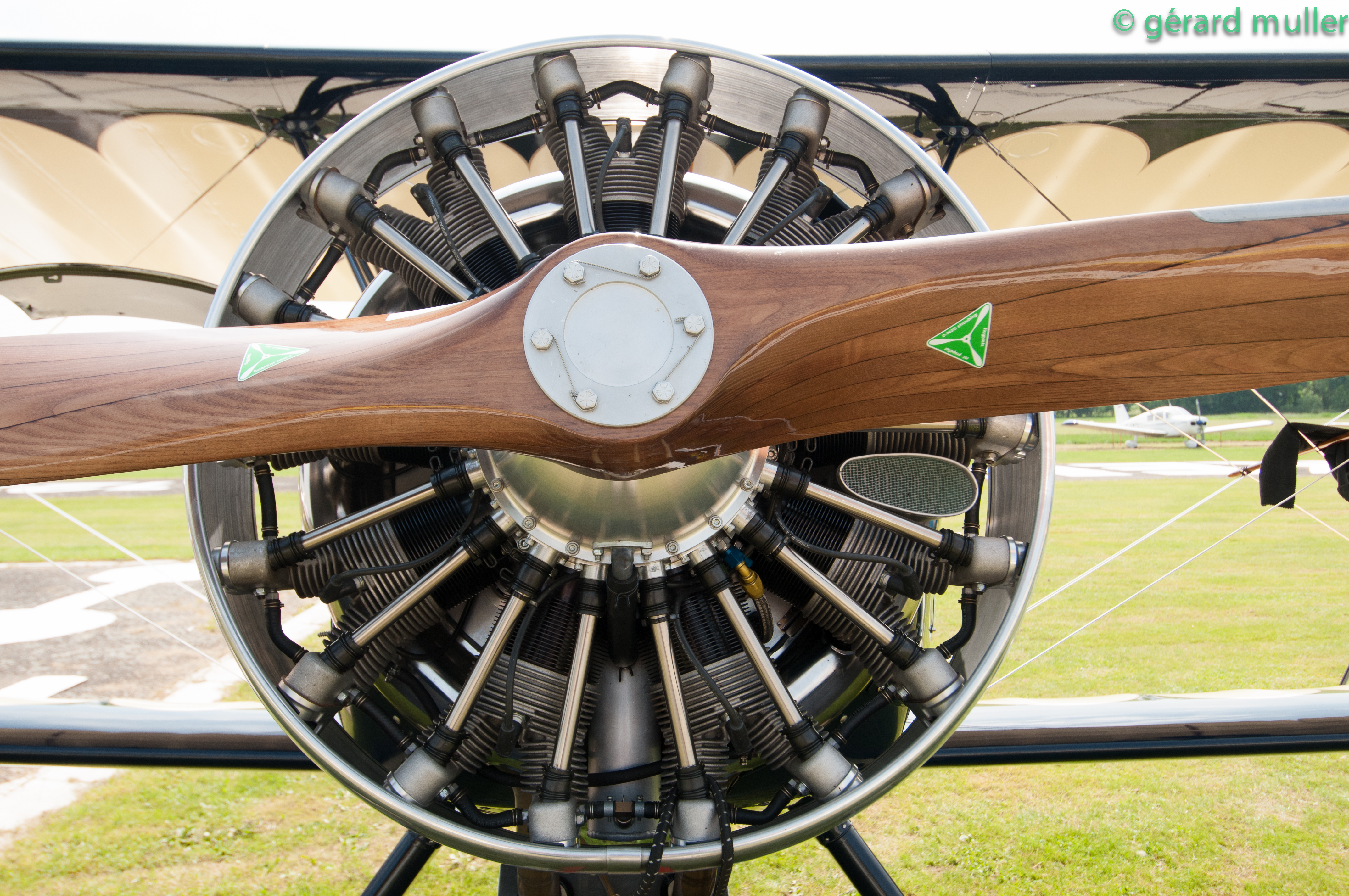

front view speedring
- front view speedring

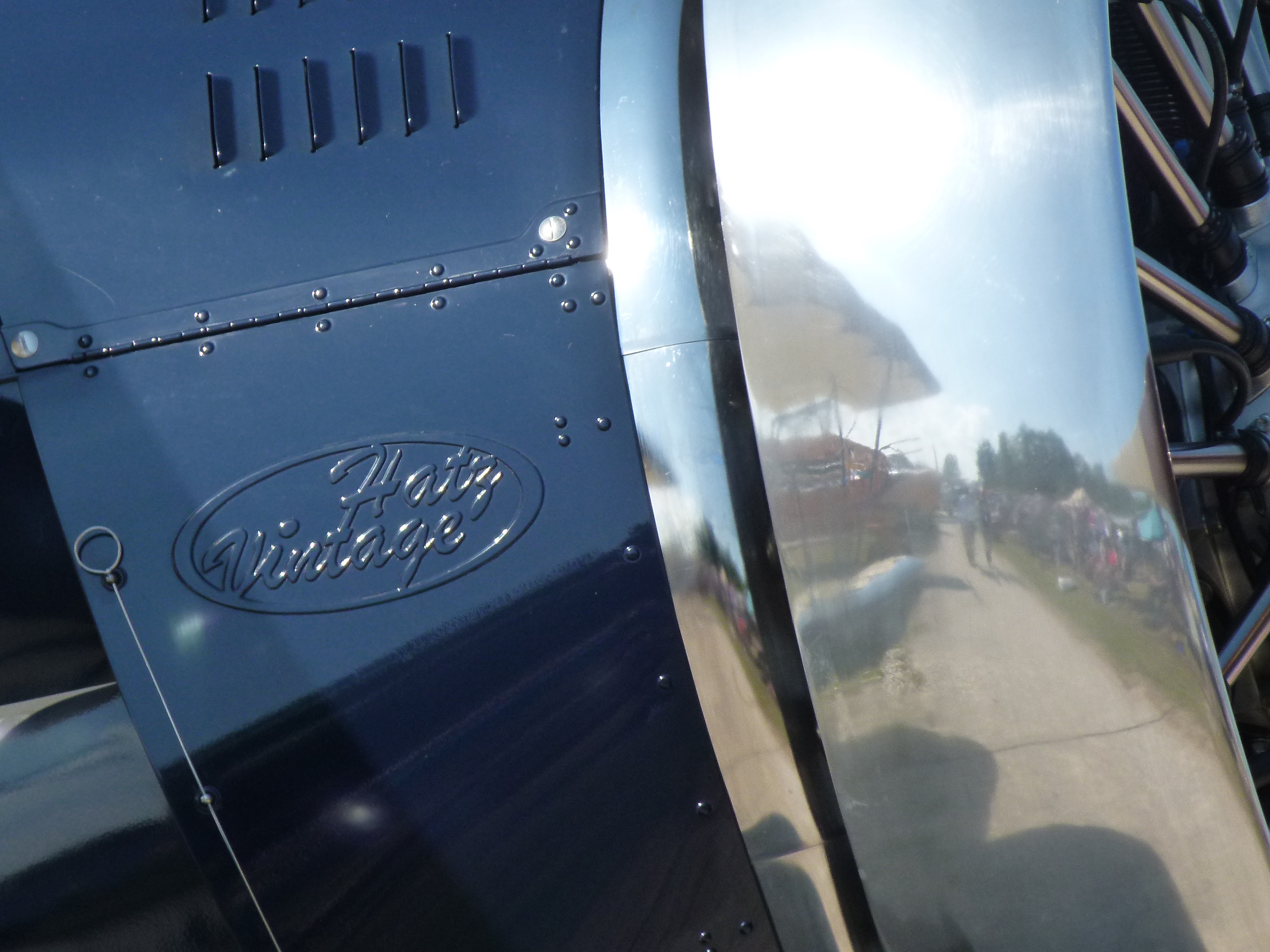

Polished speedring
- P1040474.jpg (2.1 MiB) Viewed 30950 times

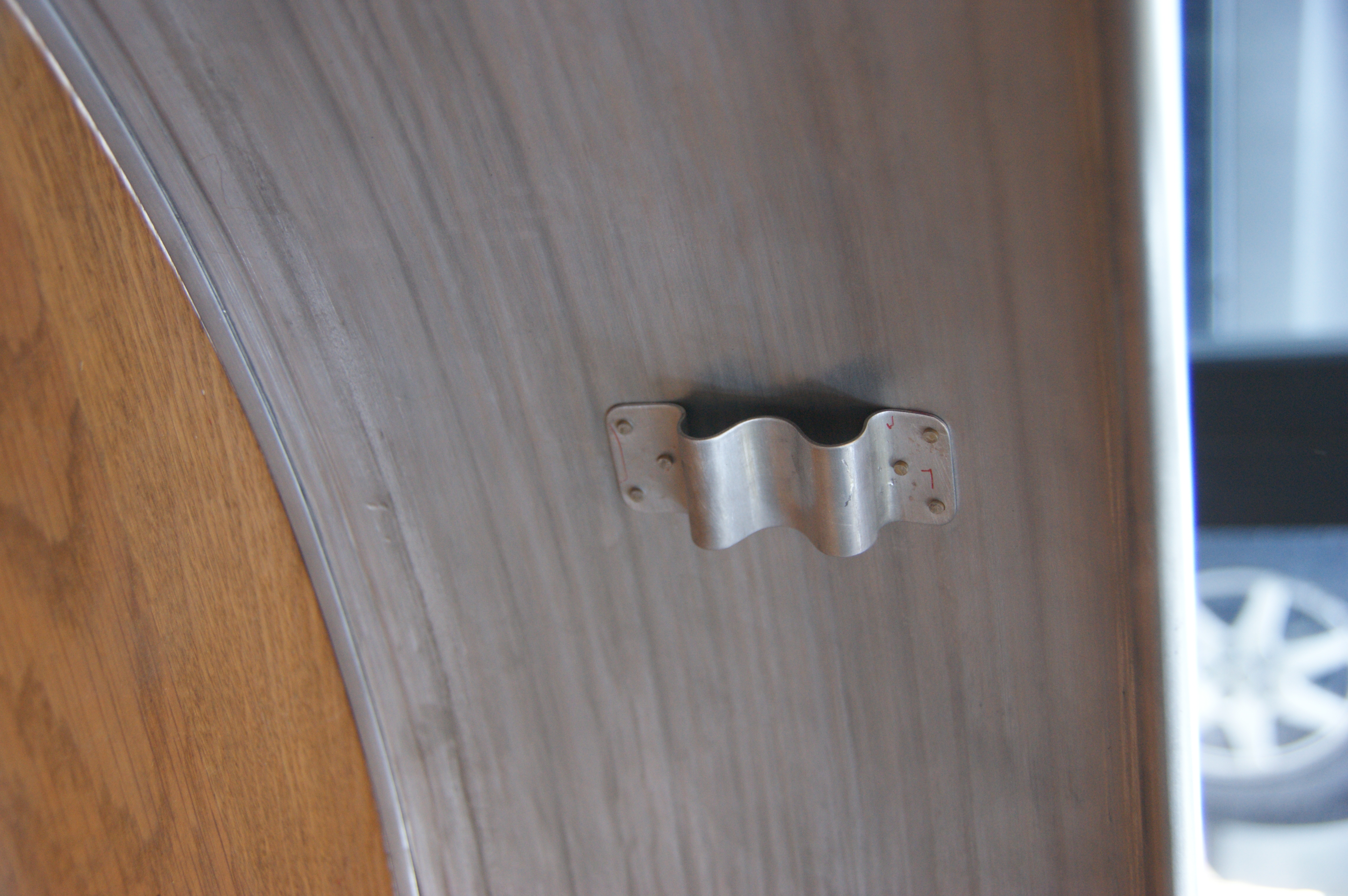

speedring, formed attaching plate
- DSC03716.JPG (4.47 MiB) Viewed 30950 times
