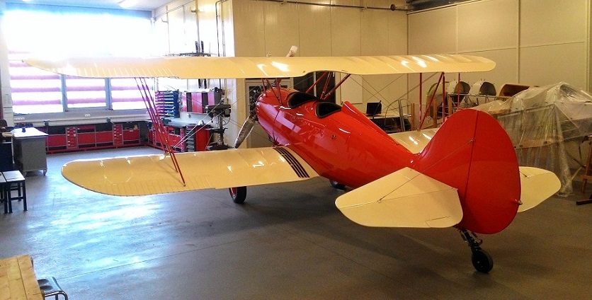

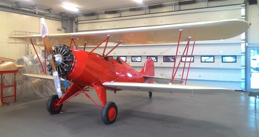

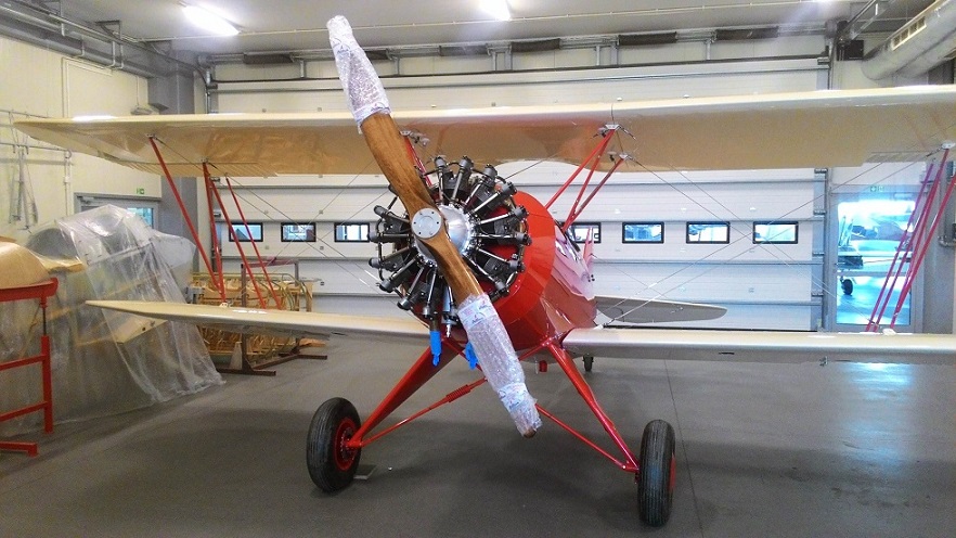

Doug, Hans and all other Hatzers; finally I can present my red colour. I think the result is better than I expected. Thank you guys again for your help and good tips. More pics on my FB (White Red Hatz). I start thinking about first flight... but winter is coming...

Hi Wojtek,
Very, very nice! You seem to come to completion and first flight. As far as computer colors are true - it looks like you machted the 1930's colors perfectly!

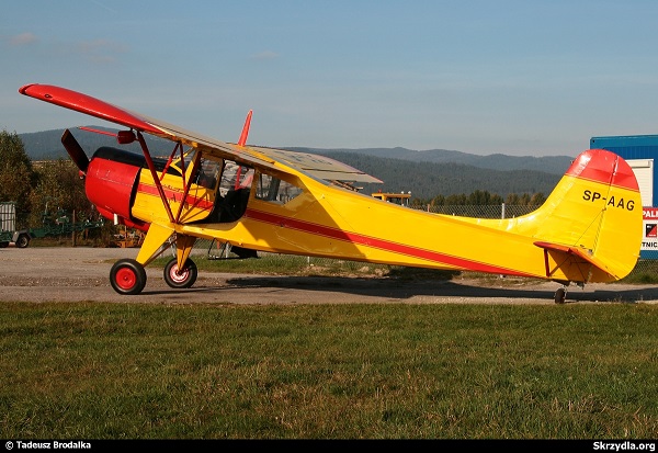

You have the nicest pair of wheels I have seen for a long time (apart from the Bendix type wheels we have, of course....)! Please give us a hint about the brand and size.
The wheels are perfectly matching - you don't pack them into pants, don't you?
We are eager to learn about the performance figures as you have a different prop than we have! Is your Hatz shown here in a complete status, including avionics and oil in the tank? What is the empty weight (ready to fly without gas)?
We wish you all the best for the first flight and hope to meet you and your Hatz in the not to far future! Would like to get made some formation close-ups then. Your Hatz, we guess, will be the second Classic with a Rotec radial to fly in Europe!

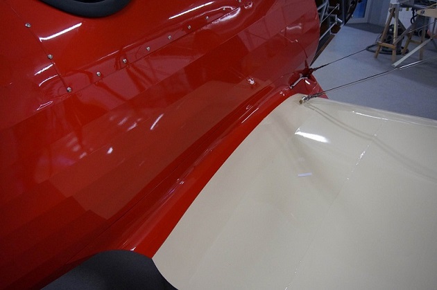

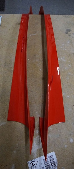

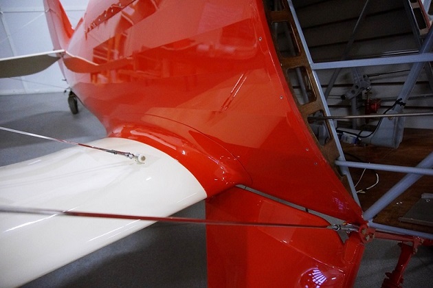

The wheels will be exposed. I adopted them from the Yakovlev-12. Size 600x180mm. Pretty heavy... The brakes though are super light: the Beringer. Here you have some pictures with the wing-body fairings.

Great work, Wojo! Great to see another Rotec Hatz out there!
I see you have fillets for the wing root. I'm really interested to hear what you see for cruise & max speeds with those installed. Mark Lightsey installed those on his CB-1 and said they were good for at least a 5 mph increase in speed. There an older article from Kitplanes magazine that discusses just how much drag is created by that particular joint and how one can gain some speed simply by doing what you did. Let us know what you get for speed once you start flight testing.

It surprises me that the wing/fuse fillet makes that a speed advantage! Is this because the round shape or because the pressure cannot release or is it both? The speedring also makes a few mph..
