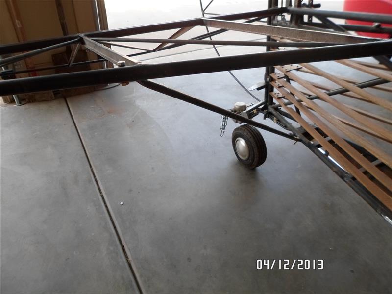

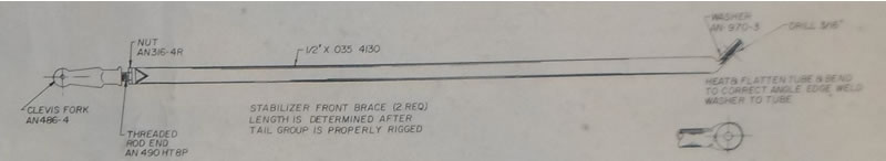

I'm using 1/2" 4130 round tube for braces as shown in the attached pictures. Pretty much duplicated what's on the Acro Sport II plans. It's a proven and very inexpensive method to add support to the stab. If I used 4 wires with terminals from Bruntons it would cost about $700.

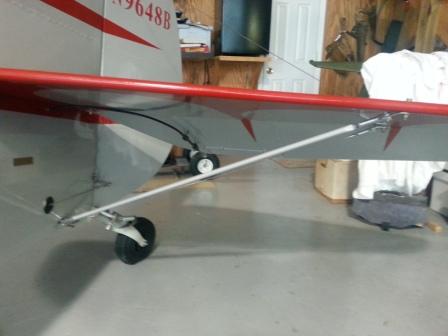

Horz stab is vibrating. I took a small hand mirror along and could see the right side vibrating in the wind. I am going to add a stramline strut on the bottom of the leading edge back to the fuselage. I think this needs to be a plan change on all future plans.

The Fix
Support strut.jpg (21.68 KiB) Viewed 3625 times
