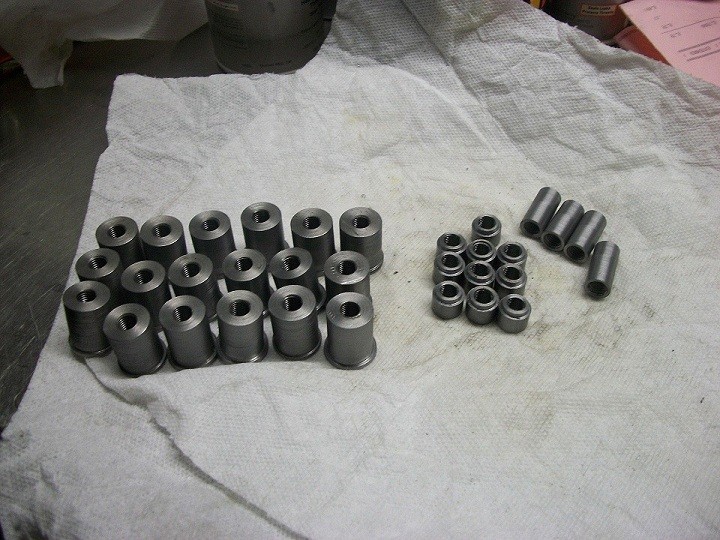

You will also have threaded plugs of two different diameters. The ones that fit in the cabane & N struts are different than those in the compression tubes.
Here a pic of mine before they were finished...
- 003_b_sm1.jpg (156.61 KiB) Viewed 2787 times
