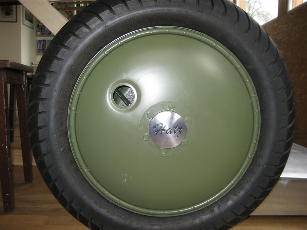

Here is a reply I received from Hans & Sam:
Dear Nick,
We understand well your enthousiasm about those slim high pressure
wheels. We got also excited, when we first saw Mehlin Smith's Warner
Hatz with such wheels!
However, in the meantime we are a bit concerned about the sideload
capability of such wheels: Some pilots are telling nightmares what can
happen when landing in strong crosswings and others tell there is
absolute no problem. We think it is mostly a matter of inertia loads
and a real problem is anyway only on paved runways!
The only data we have on hand (we don't have any drawings) are:
Wheel (tyre) dia: 24"
Rim dia: 16"
Tyre width: about 4"
As you know, they were build by Dick Fischer from California and two
friends at Brodhead, WI. They were not cheap to say the least, but
they are equipped with Grove hydraulic disc brakes.
As we noted several times, we still haven't found the smooth tyres we
are looking for. We came no close to a suitable Metzeler, which we
will have to grind smooth.
We bought our wheels with Baracuda 130/90 motorcyle tyres (not
mounted), but the would not fit smoothly. They showed some bad
centering, which yileded in a sort of "Jimmy" (not turning smoothly).
However, this July at Brodhead we detected that Mehlin's wheels didn't
run smoothly as well (he might have the same problem!
There is a Hatz modified to look like a Travelair 4000 flying (I
beleave in California) with Fischer 24" wheels and this has Dunlop
120/80 tyres mounted. As far as I know, this runs nicely.
However, Mehlin turned from 120/80 to 130/90, because he wanted some
more energy adsorption. The static load capability of 120/80 tyres is
about 250 kg whereas the 130/90 is about 280 kg (it is difficult to
determine what's needed, so, the more the better).
We are also in contact with PUR SANG Aero Historic of Argentina. They
are building tyres for their 19" (rim) wheels for their Avro 504. The
plan to build a tyre for the Gispy Moth, which has a 15" dia rim
however. Ron Souch of England (the Gipsy Moth restorer par excellence)
is offering spoked wheels with 15" rim for the Gipsy Moth (which is
much heavier than a Hatz).
Dear Nick,
Rim dia: 16"
- Hatzwheel.jpg (73.67 KiB) Viewed 4489 times

Re: 16 inch wheels
Nice. Is the inside rim a casting? ... spoked? Is outside an aluminum shell?
The issue with side load failures, does anyone know of the construction?
Thanks, great start.

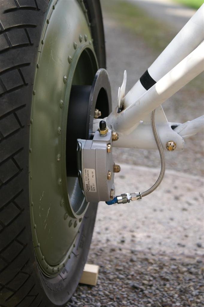

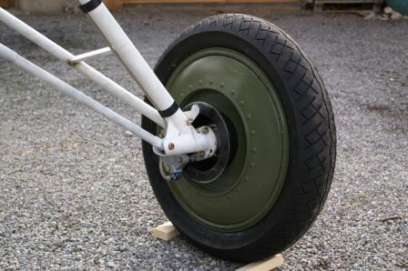

Re: 16 inch wheels
There is a cast aluminum hub, which carries the brake disc. The aluminum discs are stressed skin and hold the wheel together. There are no spokes - this is a patented bendix wheel!
a couple of more pictures.
Hans & Sam
Hans & Sam
- PICT0103 (Large).JPG (64.64 KiB) Viewed 4488 times
